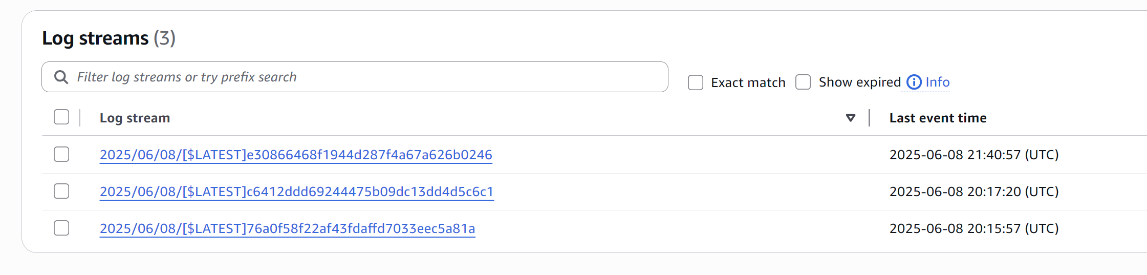

I’m not seeing any HA Logs that show Assist, I suspect the Skill is not even invoking. When I ask Alexa “open House Bot”, it tells me “House bot is not available on Alexa yet.”

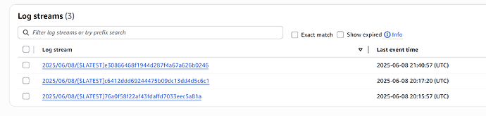

When I look at AWS’s CloudWatch Logs screen all sections/graphs are completely empty
I dont think any is happening, I suspect these logs are from my setup…
So, you probable have any skill setup issue or something like this.
