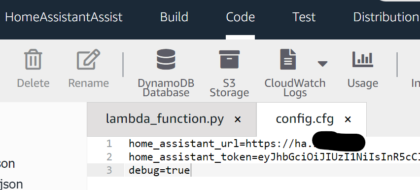

by configuration key do you mean the URL in config.cfg?
Its always had it… I tried both HTTP and HTTPS. The long lived token has also been the same for 2 weeks.
I just tried it again and have the same errors in the log. Are you sure its actually reading the config.cfg?

I did this and it did not fix anything, same error. the key looks like this…
alexa_speak_welcome_message= Welcome to the Home Assistant voice assistant! How can I help?
the log looks like it is not using the config file to get the URL… otherwise why would it keep showing… HA request url: https://YOUR-HOME-ASSISTANT-EXTERNAL-URL/api/conversation/process
This looks like a huge bug to me… does anyone have this actually working? Does there log have a real URL or this placeholder?

I confused it with the other user’s question, your case has nothing to do with the language file or zip file, sorry!
Restart to your first post regarding URL!!!
You image shows that you configured the URL:
After any changes in the code or config, you need to Save, wait finish, Deploy, wait finish, go do Build tab, click in Build skill.
You did it?
thank you, I got it working. It didn’t deploy all the files before. That was not obvious in the web page.

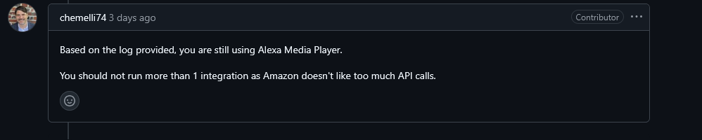

you need to setup with a media player *the alexa you want to target* → the media_player entity ID of your Alexa device
the only integration that allow media player on alexa is (Alexa Media Player) the new Alexa Devices Integration needs to remove the AMP
in your docs you never talk about Alexa media player integration for the conversation starter prompt in the future AMP will disappear as will be replaced with the new one
I understood.
When I released this skill, the oficial Alexa integration did not yet exist, the only way to do it with Alexa Media Player, but I’ll write a line with this warn.
