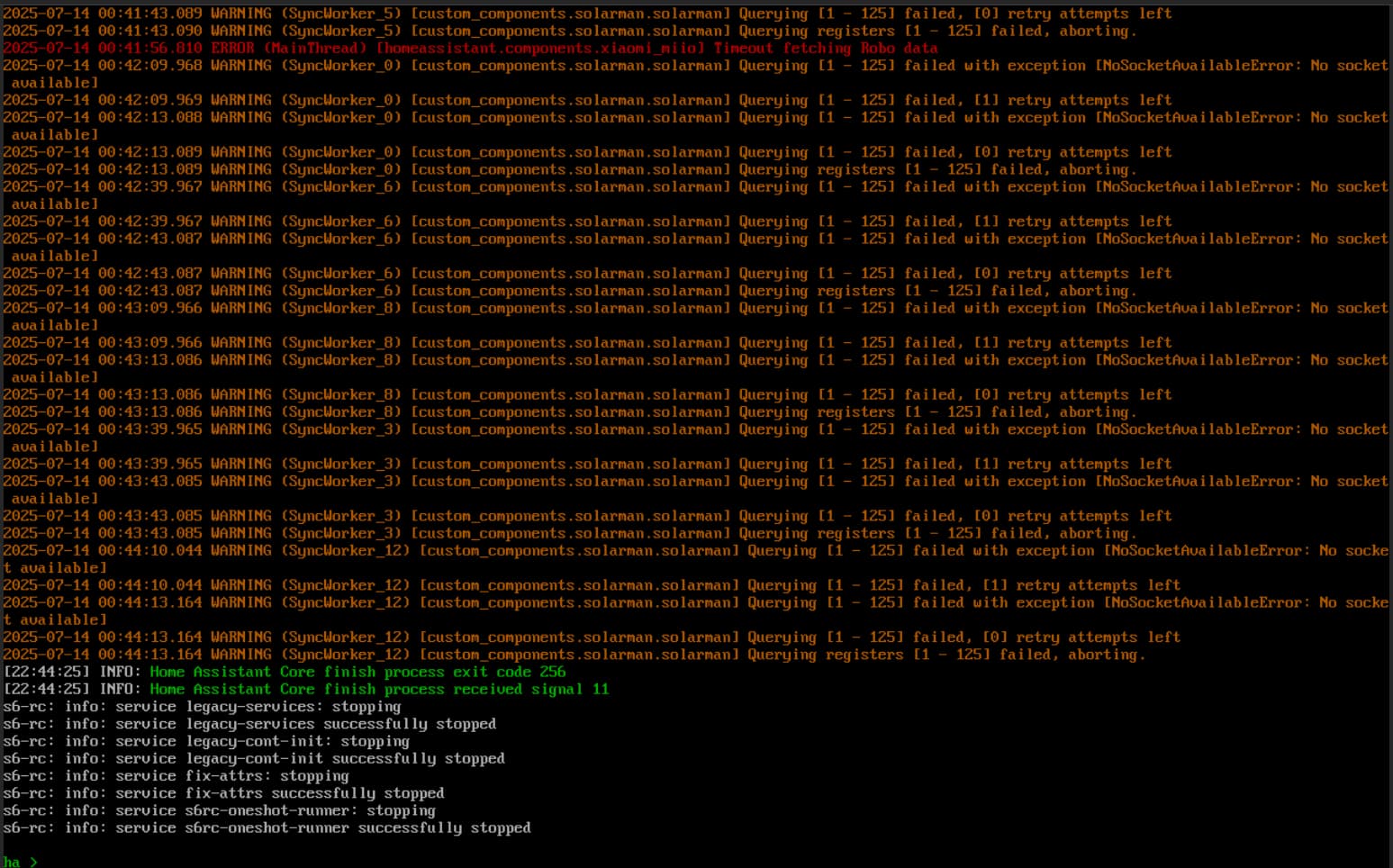

Logs:

Out of curiosity - I see a bunch of errors with Solarman when you’re offline, but the Solarman integration in HACS says it uses a local connection. How are you testing the “no internet” scenario? Asking because it should still find devices on your local network, unless you just pulled the ethernet cord going to your server.

That’s a good point.
Normally, everything should run locally, so I’m not sure where the errors or warnings are coming from.
My access points are still online, and so is my OpenWRT router — only the modem lost its connection.
I suspect it might be related to NTP.
