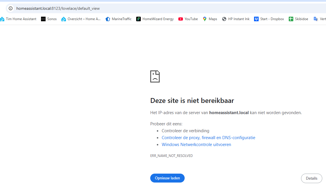

Until yesterday my HA worked fine. Today i could not reach the HA App away from home. I use Tailscale to connect.
When i came home no connection was possible on my desktop, laptop or GSM using the homeassistant.local:8123 or by IP address.

Update, got things working again but don’t know why exactly.
I contacted my Network distributor and it seemed the day things went wrong there was a big internet connection loss in our street. They think that in the period of restarting the internet connection something did go wrong while creating the IP addresses. My HA run’s on a static IP ending on 100. They advise me to chose a smaller number becouse this one is to close to the random chosen ones.
Don’t know if this is the answer but didn’t find any other reasons
In other words, being a little bit more technical, you didn’t configure your router for Static IP, and the IP address used was allocated dynamically using DHCP (it often just picks the next one available).
This explains the ‘random’ aspect of your IP addressing dilemma, when your external network interruption was eventually rectified, and your router restarted.
This would have made the penny drop as you would have noticed any IP address issues your network distributor help desk hinted at.
Go back, check how you are configuring the choice of allocating IP address, check the router DHCP settings, and adjust accordingly, otherwise you may find the problem may happen again.
I strongly recommend pre-allocating Static (fixed) IP addresses for everything. That way you are in control and not subject to the DHCP whims of your router, you know what to expect, and where to look if a device cannot connect. Your networked devices, looking for each other to communicate will also be able to consistently find them easier and faster. If anything goes down, it will come back in a known state on their allocated IP address, because you told it to.
