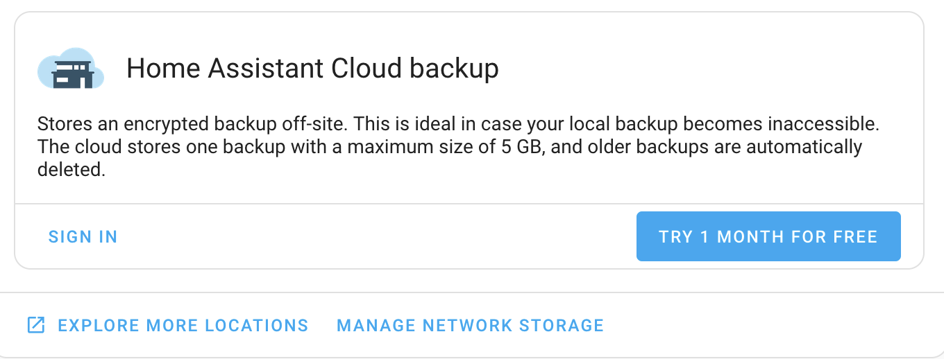

I have Nabu Casa paid for. Randomly, “Home Assistant Cloud” seems to have disappeared from My Home Assistant OS setup!

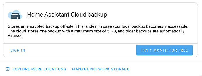

The only place I can find reference to it is in the backup section, where it says I need to log in, I try to log in, and it just sits spinning!
Any help please? I even tried restoring back to the previous version but still not there.
