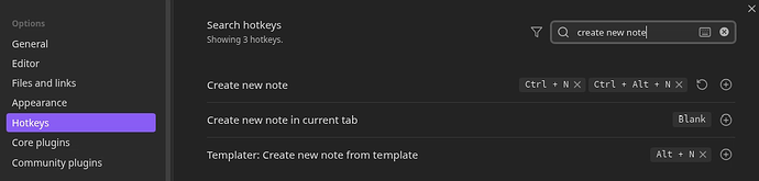

I’ve installed it and it appears to be working. Over the coming weekend I should be able to test things out a bit. One thing that I’ve always been disappointed with is CTRL-N doesn’t work for creating a new document. Is there any documentation for alternate keyboard shortcuts that don’t interfere with those already in use by the web browser hosting the Home Assistant page?

It’s possible to assign a new hotkey to any Obsidian action. I’ve checked and it works well.
