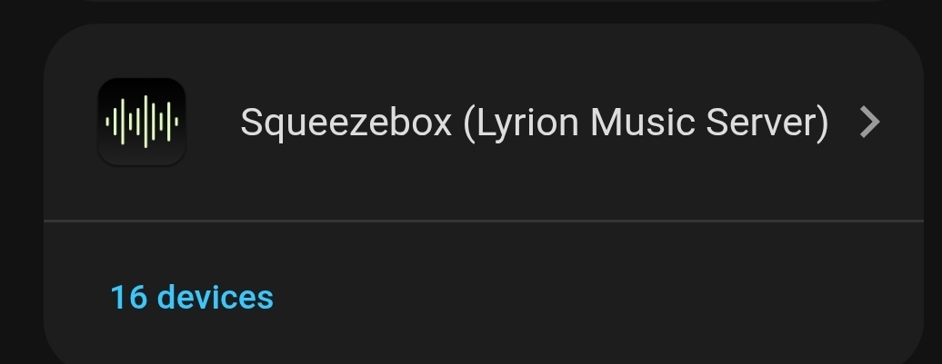

Hi all,
in order to use the kidsplay plugin I had to enable username and password in the LMS security settings.
This led to the Lyrion integration not able to connect to the server anymore…as expected.
But how can I add a username and password retrospectively? I did not see any “reconfigure” option that would allow this.

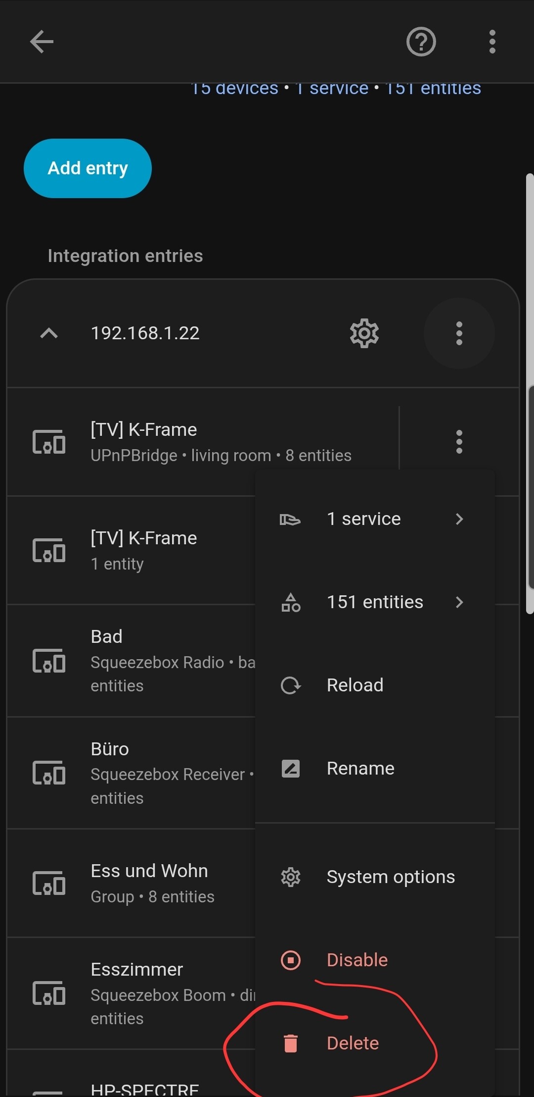

So I tried to delete the whole integration but it seems that HA does not like this. As soon as I try to delete the integration HA looses connection and reboots (I think). It takes about 5 minutes until the system is back, Lyrion still not removed.
The easiest would be to add the credentials somewhere…but where?

You’ve posted this in the LMS addon thread - did you mean to? The Squeezebox integration is different - just checking what you mean as there isn’t a “lyrion” integration - it’s called Squeezebox - the core team don’t want to change it. The HA reboot behaviour sounds more like removing an addin.
Your core question though - there isn’t a reconfigure - you just need to delete and re-add the config entry (not the intergration)
Hi psketch,
Sorry, you are right. I confused addons and integration here.
And I indeed was referring to the integration. And since these days it has the Lyrion name in the the label called it that
I tried to delete this, which is not the whole integration of course but the entry for my Lms server,
but then HA did not react anymore and rebooted. But the entry was still there.
So I would not know how to add the credentials.
Thanks
Merc
@Merc You’re doing the right thing to delete the config entry. In general, once you’ve deleted the config and re-add it, HA will recreate the same entities based on the mac address of the players - so deleting and re-adding won’t affect your automations etc…
However, what you’re seeing is not normal - it sounds like something’s corrupt in HA somewhere. There’s no way deleting a config entry should crash HA. I’d suggest you post a question on the support discord perhaps.
