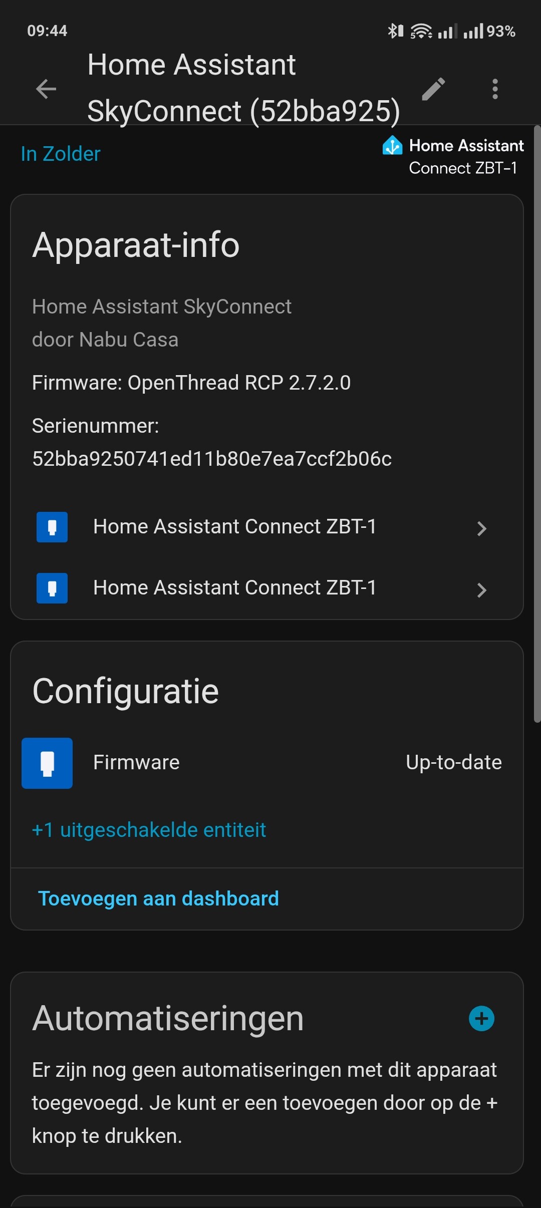

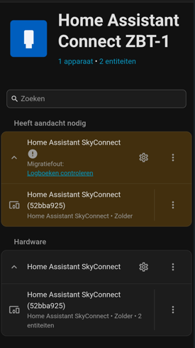

Since the latest update of Home Assistant Core, I’m seeing the following message for the Home Assistant Connect ZBT-1 integration:
“Migration error”.
I can’t find anything related to this in the logs.
The SkyConnect is still functioning correctly as the radio antenna for my Thread network with (only) 7 devices.
When I click on the integration, I see a “needs attention” message.
If I then select the “Home Assistant SkyConnect” device within the integration, I see the same “Home Assistant Connect ZBT-1” entry listed twice under Device Info.
Does anyone know the easiest way to get rid of this issue?

Today, I decided to make a full backup and then delete the "Home Assistant SkyConnect" integration (the one causing the migration error). After that, everything seems to be working normally. The other entry with the same name in the integration remained fully functional.
As a result, I no longer have any migration errors.
Thanks VictorvandenHoven
for the tip. I hadn't dared to simply delete the highlighted device, since it is identical to the one currently in production use. But it worked — only the entry containing the error is gone now, and Thread on ZBT-1 is running just as it did before.

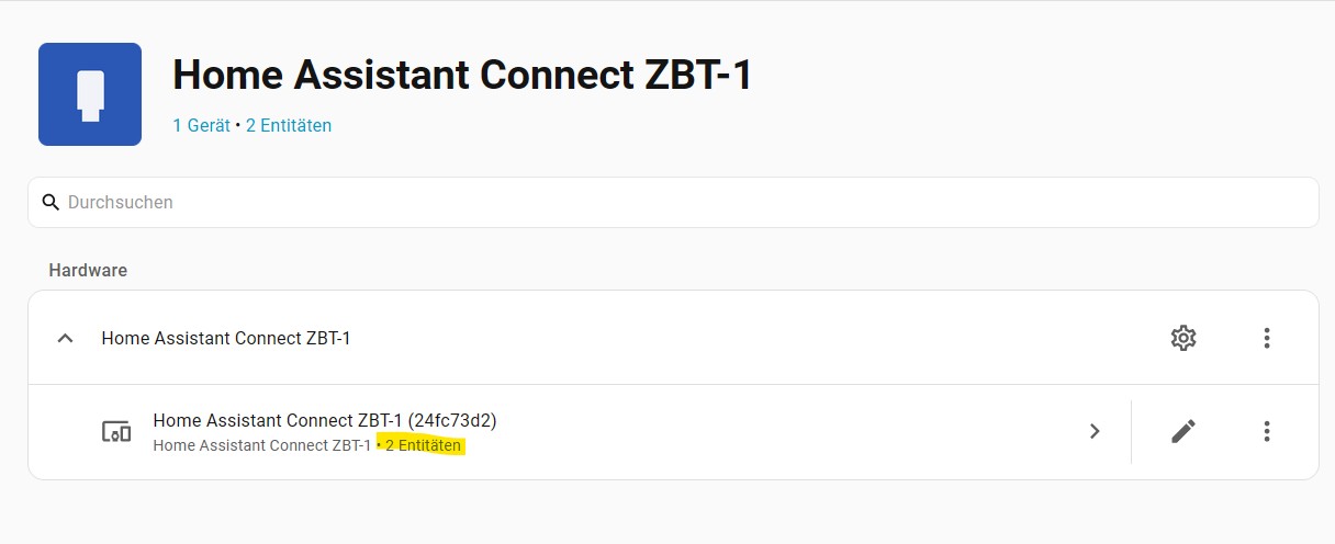

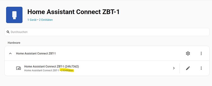

Correct: There are two entities:
One device (the USB stick) with two entities:
  • One for the firmware
  • One for beta firmware updates
You are right. Before the release, there was only one entity. That is why I thought the display was incorrect. But the "Beta Firmware" entity likely appeared with the release.
