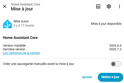

Hi there,
Almost everything is in the title… Since 2026.7.X came out, I can’t update anymore (was done on a regular basis, my current version is 2026.6.4)
I press on update button, it does something and come back but update is still there..
Here are my current information:

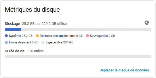

Raspberry Pi CM4008016 Compute Module 16 GB, 8 GB RAM
This is what I ordered back at that day, but if I remember right, I did put an extra “big” disk and configured it:
Anything I can check on hardware side (with a command)?
