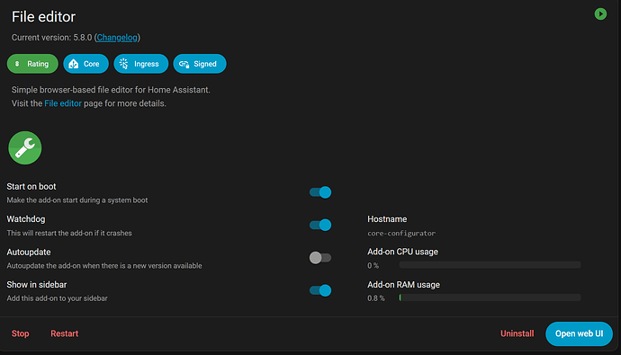

No cameras. As for addons, these are below. Is there a quick way to check the memory taken by each add-on?

Yes, every Addon page will show you how much CPU and RAM it’s using
Thanks, in the meantime I found Whisper was taking 40% CPU.
I switched that off and ha has stopped rebooting. It is also much more responsive.

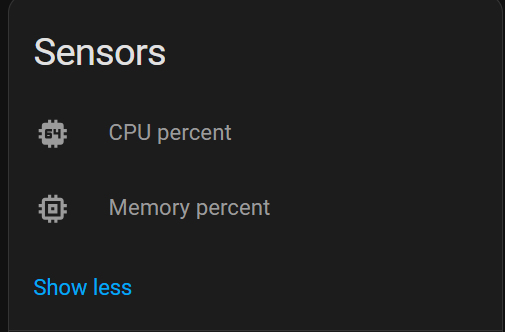

You have 2 options:
  1. Install System Monitor integration. This won’t give you a detailed breakdown, but at least it will give you a general overview of resources across your entire HA install.
  2. Wait for tomorrow’s release. I don’t really follow the betas, but I seem to recall some improvements are going to be made in visualising resource consumption.

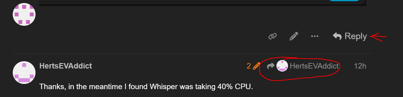

PS. You replied to your own post. If you intended to reply to me you need to hit the Reply button underneath my post so I’ll get a notification. I came across your reply just by coincidence as I was browsing the forums.
Thanks, I installed the latest release. I had the System Monitor integration running. Now I enabled common sensors like cpu.

Is the CPU usage of the core monitorable, like for add-ons?
Considering the addons you’re running (and probably their respective integrations), that doesn’t sound too bad.
Yes. Go to Settings > Devices & services > Devices tab and search for “Home Assistant Core”. Click on the “device” & enable the disabled CPU & Memory sensors
You can repeat the above steps to enable the Supervisor CPU usage sensor too, just search for "Home Assistant Supervisor " in the Devices page.

It may help folks if in future the cpu and memory sensors would be enabled by default…
