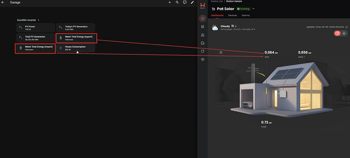

Ive just installed Home Assist on my Windows machine in a VM. All good with that
What I am first trying to do is Get home assist to read my Goodwe Homekit consumption and export monitor
which shows me My current load, what I am exporting, and what solar power I am getting in a live feed
I added my Goodwe inverter and it can see most of the statisitics but it cant see what I am exporting
I need to get this working first before I do the next thing I want to do which is getting my pool heat pump to switch to boost mode when my house is exporting like 2kw of power for over 10 mins
any help would be appreciated

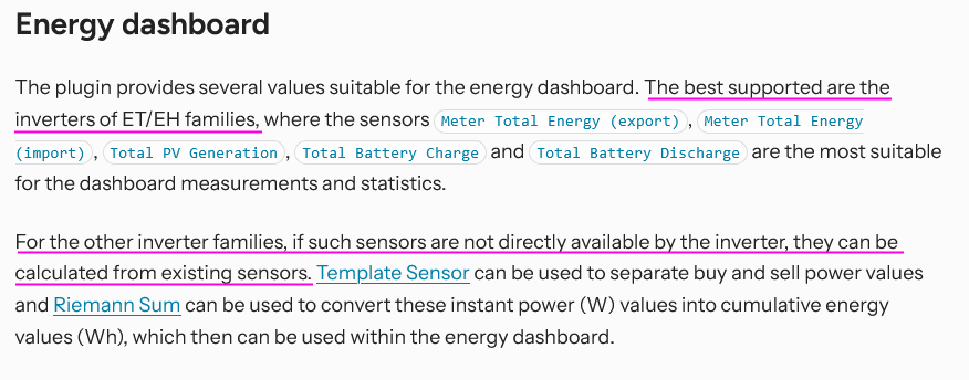

There is some info here you should read: GoodWe Inverter - Home Assistant
