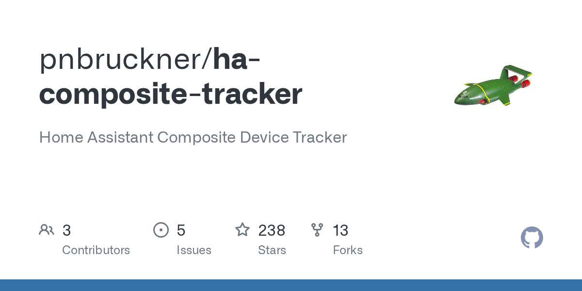

Make sure the HA companion app knows what your home wifi is in the connection settings. It may help with Home Assistant setting home based on you being connected to your wifi. If your router has an integration to create device trackers based on being connected to wifi, add that device tracker to your person in Home assistant too. Or create a ping sensor to ping your phone and add that device tracker to your person in Home Assistant. That way Home Assistant can detect you home even if your GPS might disagree.
For the ping sensor to work, you must set your router to always use the same IP address for your phone.
Personally I use this to have multiple sources of location for the same person to improve accuracy, it works somewhat better than adding multiple device trackers to your person in HA:
Thanks Edwin. For detecting who is home your suggestion will work. However, I also have zones for school, work etc, which need GPS location.
As long as you are not connected to, or near your home wifi there, there is no reason why GPS would not work there. Iām not suggesting to change anything to GPS, just to add extra means to detect home and fix that. Add more trackers, not less.
