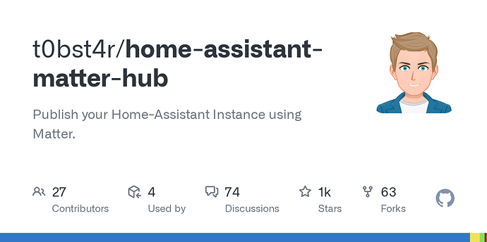

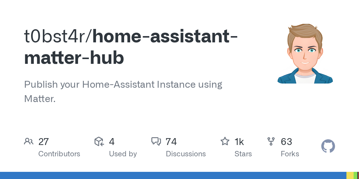

The Matter Hub posted by @HA11 works very well and is pretty easy to set up.
Thank you. I’m planning to try this out. So just to clarify, using this will make alexa communicate locally with HA using threads?
It is a Matter Hub and exposes the HA entities as Matter entities which Alexa can control, including via voice.

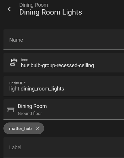

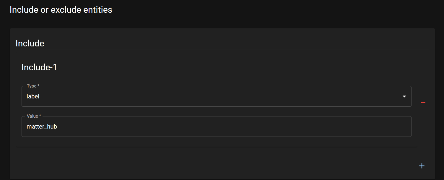

Awesome thanks. Can we choose which entities to allow HA to publish via Matter? because certain things I might not want to appear on Alex and Home Kit
Absolutely. Use the ‘label’ option, this will make sense when you install the add on and configure it.
The 'Value" can be whatever you choose. Add this label to whichever entities you would like to expose:

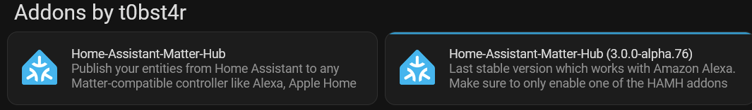

I’m still using v76 of the Matter Hub as that was the last version reported as fully working with Alexa. I hadn’t seen any reports advising to upgrade. I’ve been able to add new entities to the Hub and expose them to Alexa.
What’s the latest version currently? When I install it I doubt it will let me install an old version will it?
When you add the repository, there are two to choose from:
v76 is available separately because of the breaking changes that Amazon made.
I’m not sure what version the other is up to - EDIT: 3.0.0-alpha.93.
Also, don’t be put off by the ‘alpha’ status, v76 works solidly for me.

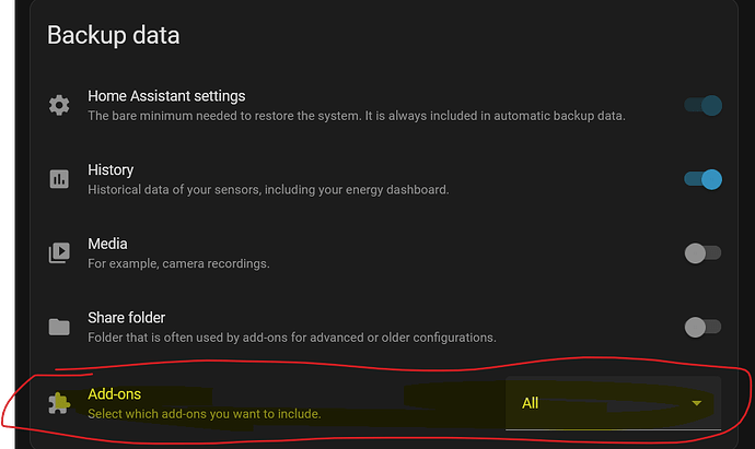

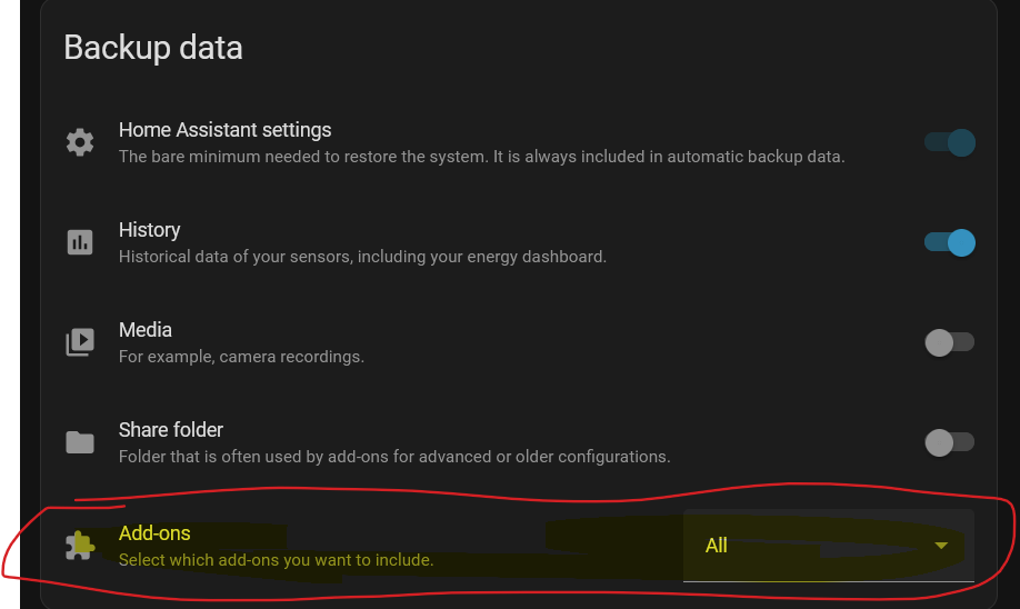

Thank you. When you backup HAOS so that you can import it back for example if pc fails and you rebuild a new pc with HAOS then import the backup, will the backup also backup add-ons and all the device connectors etc? Or is it better to maybe use something like CloneZilla and create a complete system image with the configuration that can be dumped back onto a system ?
Just make sure that your HAOS backup settings include addons:
