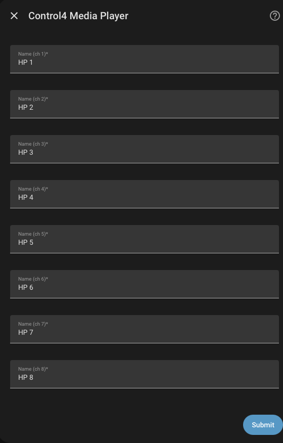

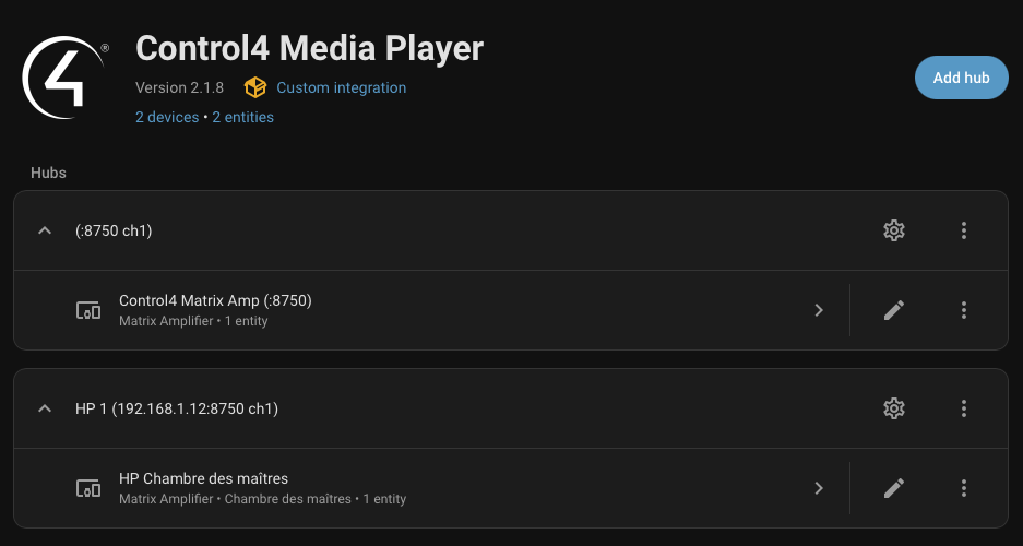

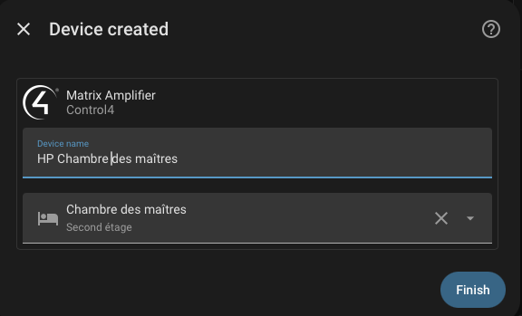

I’m trying to configure your plug-in in bulk for a 8 zones amps, but for some reason I do not succeed very well. There’s probably something I’m missing big time, but after many attempts using different ways, I always end up with something that do not make sense. I would expect to see 8 entries at the end, but what I get is at best confusing to me :smiley:
I posted a few images of what I’m doing:
And this is the end results:
Thank you
Hi @Jamon, thanks for letting me know! I have validated the problem by deleting all my devices and trying to add them back. The problem is that HA has changed the way they deal with certain device types. I am working on a fix.
In the future, it would be better to create an Issue in the Github repository.
Hello @OtisPresley
To be honest, I was really not thinking it was a bug, but the way I was using it.
I added it to Github. Next time I’ll log a bug report in GitHub like you suggested, I was not even aware this was a feature of GitHub!
Keep us posted when you have a new code to test it out.

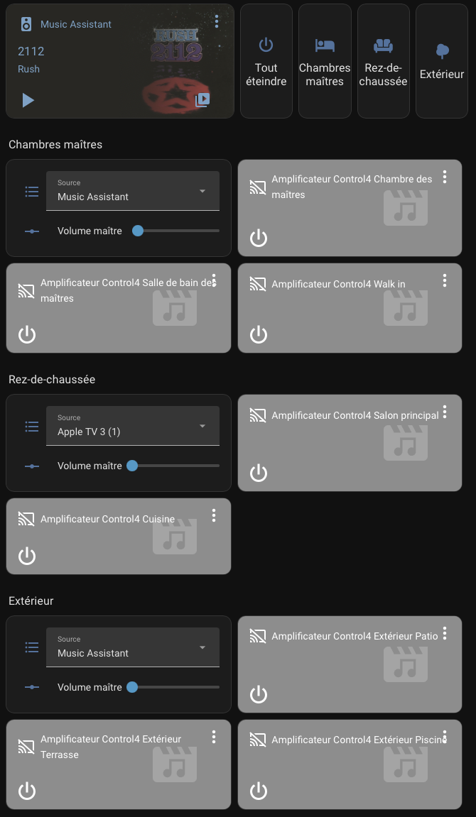

Hello @OtisPresley. Just to let you know, I was now able to add all my zones and inputs using the latest version of the plug-in: it worked like a charm. I'm now able to use the system as expected.
I had Music Assistant installed, and to make it work using the same PC running HA, I used a Griffin iMic. I was not using the device anymore with my computer anyway. I plugged it in the PC, with a cable going to the first input of the control4 amp. Then I installed VLC player and selected the iMic as the destination. In the dashboard, I have all output zones grouped by their physical location, plus a widget for the MA controls.
I bought a year or so ago an IKEA SYMFONISK remote and it can control most of the functions in that dashboard (see picture).
To accomplish all of that integration, I used Claude Code with HA-MCP, and in just a few days, I'm up and running! I may need to tweak a few more things as I use it, but so far, I've accomplished a lot in just a matter of days.

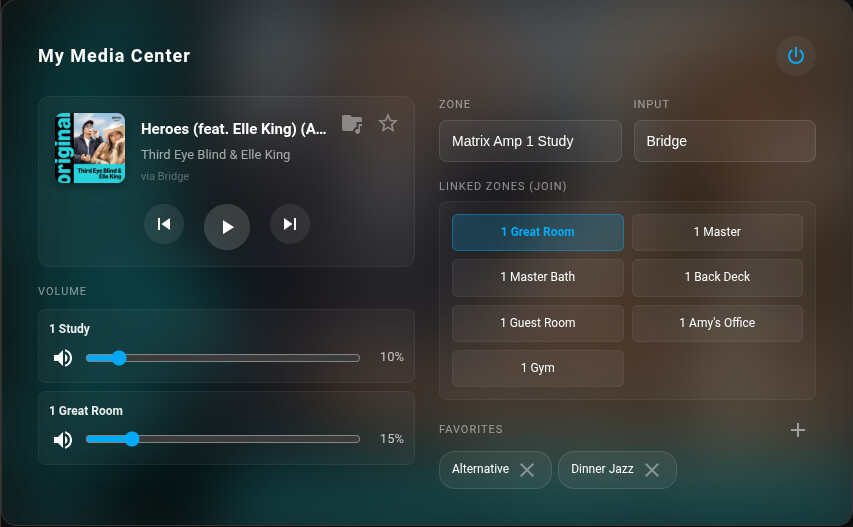

I also created a new card specifically for this integration, called Control4 Media Player Card, and am waiting for it to be added to HACS. It automatically discovers your zones and inputs from the integration, so configuration of the card is minimal. You map you inputs to media players for seamless switching.
Nicely done.
Hello Otis.
I saw the update just a few hours ago. Will give a try to the card tonight.
Do we need to download the card separately or it comes with the HACS plug in?
Tried the card, but it failed for me. Transmitted a bug report on Github.

More seriously, I tried the new card, and the bug I reported was resolved. Now I see things that make sense. I’m not sure if I’ll use it as the dashboard Claude built for me is working fine and it’s more granular per zone as would be my use case.
Claude also built some scripts that call your integration to activate zones or change the source. That’s working fine too, but when testing it (ON then OFF), if I do it too quickly (in less than 10-15 seconds) sometimes it gets a miss. But in normal use case it doesn’t matter.
Very nice job, thank you for this work you did
