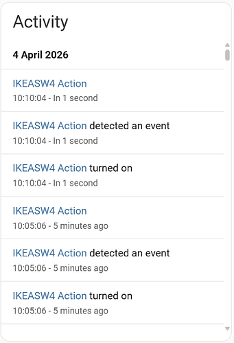

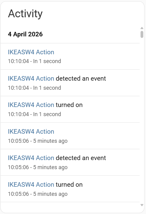

The activity log in Home Assistant shows this when I press the ON button for the first time after a period of time not using the switch. This only appears in the activity log when the automation doesn’t respond to the first press.

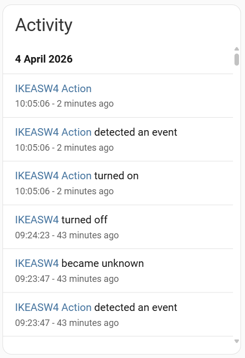

This shows that the button action was received by HA but no automation was triggered at 10:05. There is an initial TURNED ON and then a blank message.
This is the second press, which triggers the automation.

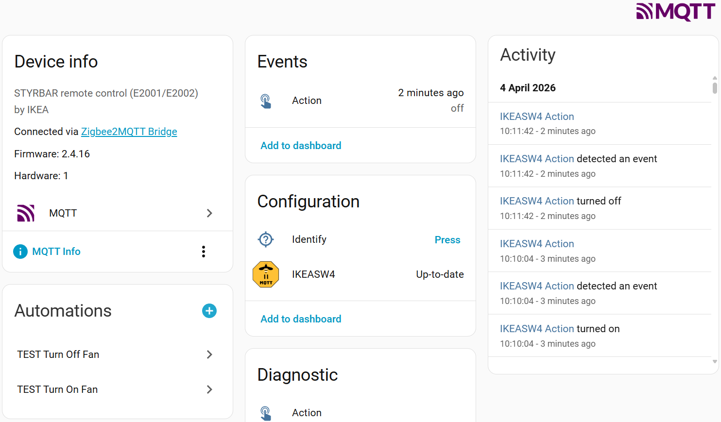

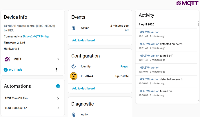

The second press is the same as the first, a TURNED ON action and a blank action but this time the automation fired.
This is the overview showing there are 2 automations. All automations that are tied to buttons are doing the same, ignore the first press after a long idle.
