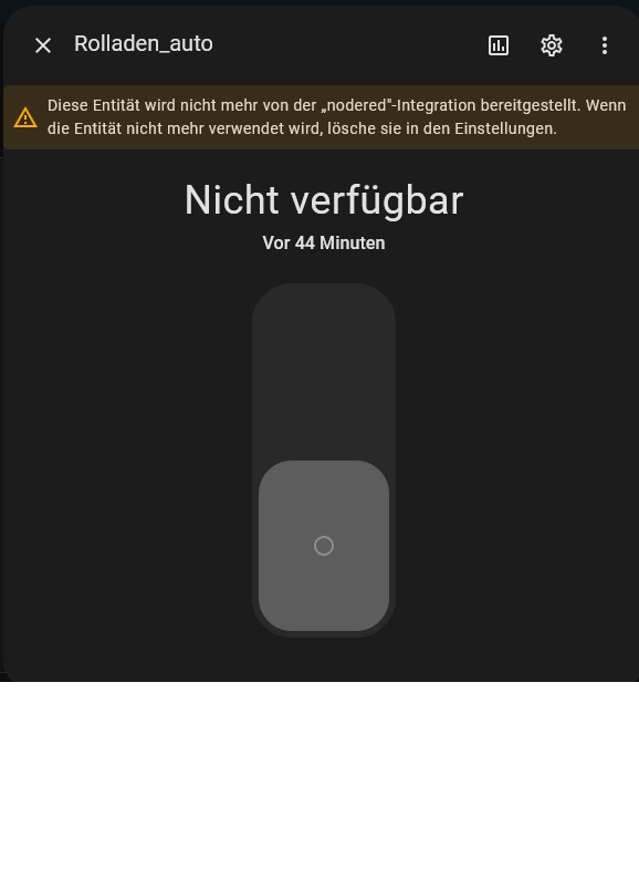

Home Assistant Entities from Node-RED missing after HA 2025.6.1 Update
since updating to Home Assistant version 2025.6.1, all Home Assistant entities (especially sensors) created via Node-RED are no longer available in Home Assistant. The connection between Node-RED and Home Assistant otherwise works as expected.

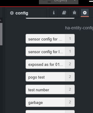

Does it show your old entities there as disabled? I am also on the same versions as you and everything is working for me as well. When you go into NR on the right choose the config node panel, do you see the config nodes for each entity?
If the nodes are there, open one and make sure you have a server selected. You should have only one ha server in the drop down. If there are more, you can see them in the same panel and consolidate them to one.
I am struggling with the same issues, did you find a solution
For me the same. After Update 2025.6.1 all nodered entities gone.
