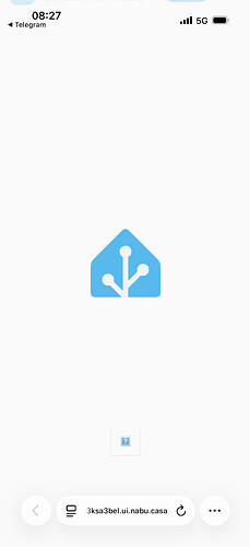

• Remote access via Nabu Casa opens the URL, shows the Home Assistant logo, and then hangs on a white screen. The frontend never finishes loading.
• When I’m at home and try local access, I get the same stuck loading screen.
• The only way I managed to access the UI locally was via an incognito browser window. Normal browser sessions don’t load.

• index.html loads (logo appears), but the frontend never initializes.
• Both Nabu Casa and local access fail in the same way.
