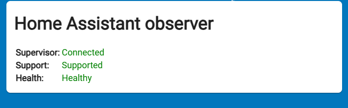

Based on what you shared it sounds like the Green is working normally, microSD resets appear to be correct, lights flashing and then turning off is what should be expected. If you keep it connected to the monitor, do you see the Welcome to Home Assistant terminal? Do you see your IPv4 address there? Are you able to access port :8123 or :4357 using that IP? For example, my IP is 192.168.1.15 so I access HA via 192.168.1.15:8123, 192.168.1.15:4357 should show you the observer.
