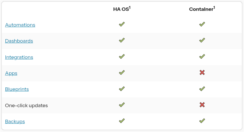

Obviously installing this App is not supported when using Home Assistant Green, it says so, but why? If there are no Apps/Add-Ons then half or 2/3 of all Home Assistant stuff does not work, no? What would be the point of that?
Just trying to understand if I'm missing something obvious, or if I have to send back the HA Green and build it myself on a NAS, as I did before.
Ok, never mind, it literally says so on the front page for the different installation methods, but I was too stupid to check... :sleepy_face: oh well...
Edit: I still do not get it. It says on the website
The affordable Home Assistant Green is the easiest way to start using Home Assistant. It's plug-and-play and comes with Home Assistant Operating System already installed.
