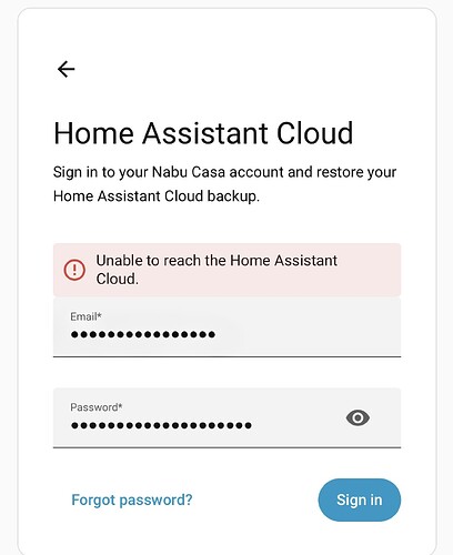

I had an issue with my home assistant green past week so I needed to restore it, after doing so I got some issues so restored it again and that part worked great.
The issue was HA could not upload the backup to the cloud, I tried singing in and got the “Unable to reach the Home Assistant Cloud” msg. Restored it and instead of restoring to my latest local back up, from the fresh HA set up I tried logging in to the HA Cloud and still got the same msg.
Any ideas on what o could do? I have not set up my home assistant green as a new home, restored back up or anything since getting that error msg from the freshly restored it is still seating on the “set up new home or restore from cloud or upload back up” screen
Edit to add screen shot, removed my email address from it

Between you HA server and the NabuCasa cloud there are several ISP contributing to the internet backbone.
One of these can have issues and although traffic should be rerouted through other connection theb it is not always the case.or the alternative routes become congested and add to the problem.
I totally understand that. However, if that was the issue, I should have experienced it before the restore as well, no?
The restore was local, so it should not have any affect on what happens outside of my network
Such failures are temporary and can happen at any moment.
Other than that it can also be the router that have gone mad and need a restart.
This could be the reason, as your HA is not up and running yet
Try to use another Device, and connect through a browser, to complete the setup ( Don’t install/restore with the backup before you have finnished the setup, then try to restore manually through th UI
i haves started the entire network, but ill do it again now, :crossed_fingers:hopefully this fixes it
I will do this now!!! I contemplating doing this but thought the back up used to restore would over ride the previously done set up!! Thank mate
