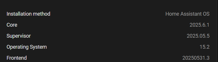

I have been running HA Green for sometime and can’t understand why it won’t receive updates any longer. As you can tell I stopped receiving updates in June.
I have checked my DNS even though nothing has changed and I am using 8.8.8.8 and 8.8.4.4.
If I try to manually update through the terminal using “ha core update” I receive the following response “Error: Version 2025.6.1 is already installed”.
Does anyone have any idea what is going on here? Thanks.
2025.6 had a kink. (Sometimes 2025.7 as well)
Some systems didn’t get the memo to update.
Reboot the host (not restart the machine)
It’s been a few months so I suggest doing a config check first on this page
Open your Home Assistant instance and show your server controls.
Then reboot host here click upper right corner
Open your Home Assistant instance and show hardware information.
and click advanced
Thanks much! That resolved it.
