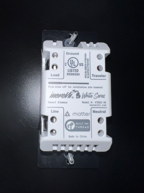

  • Inovelli White Series Smart Dimmer
  • Model: VTM31-SN
  • Matter over Thread

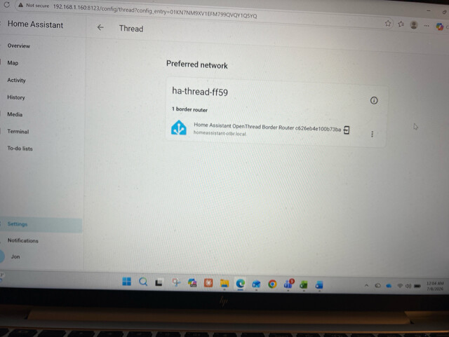

Thread Configuration
  • Preferred Thread network exists:
    • ha-thread-ff59
  • One Home Assistant OpenThread Border Router

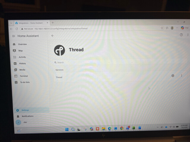

  • Thread integration shows healthy
  • Matter integration is healthy

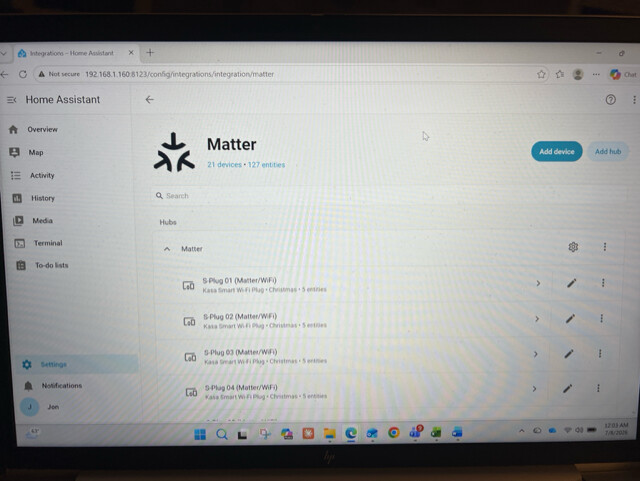

Matter-over-Wi-Fi devices are already working correctly (21 Matter devices currently connected, all Kasa Matter/Wi-Fi devices).

I cannot commission any of my Inovelli White Series dimmers.
I currently have seven VTM31-SN switches installed, and I have attempted commissioning on several of them.
Every one fails identically.

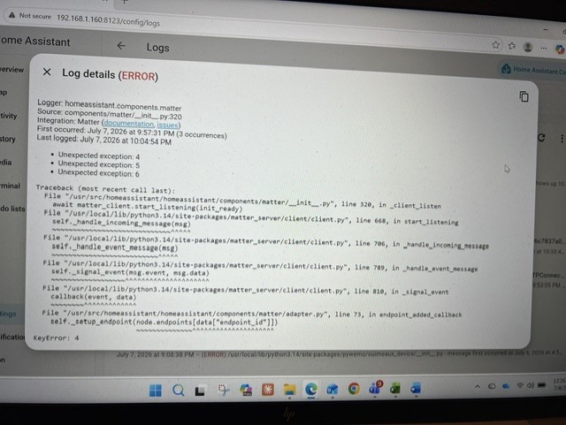

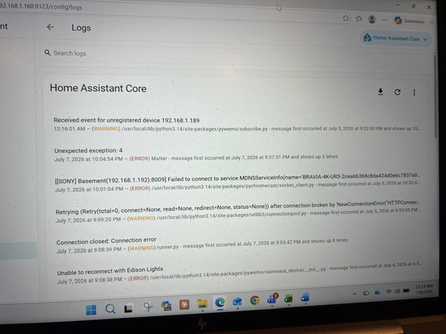

Home Assistant Logs
The log consistently reports:
Unexpected exception: 4
Unexpected exception: 5
Unexpected exception: 6
Expanding the traceback shows:
Logger: homeassistant.components.matter
Source: components/matter/init.py:320
KeyError: 4
File “/usr/src/homeassistant/homeassistant/components/matter/adapter.py”, line 73, in endpoint_added_callback
self._setup_endpoint(node.endpoints[data[“endpoint_id”]])
The traceback appears to indicate that Home Assistant receives an endpoint-added event but then raises a KeyError while attempting to access endpoint 4.
