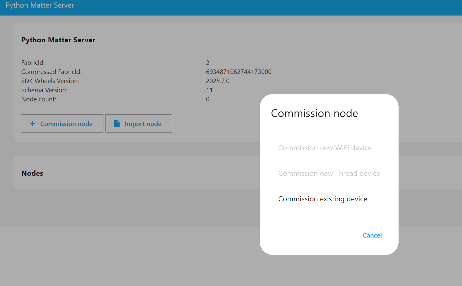

Within Matter Server UI, the new thread device is also grayed out:
I guess I would need a BT adapter for that?
Yes… that’s why its grayed out
