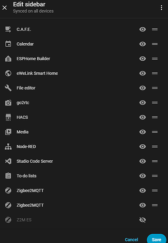

Click your user picture in the bottom left, then Edit them from the following Profile setting
Do you see them listed there when they're not showing up in the sidebar?
No, there are my original names for both Zigbee2mqtt instances - hidden - but none of the other missing items, Node-Red, Advanced Terminal etc.

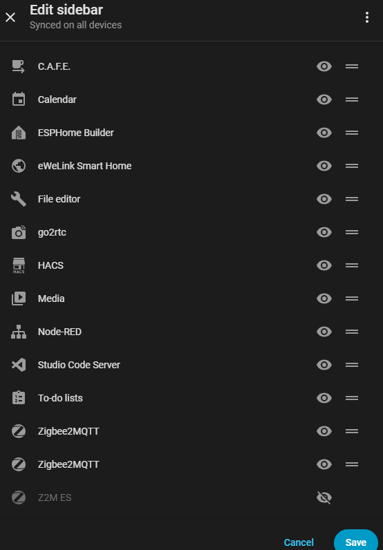

If I untick "show in sidebar" for items that should show, then tick again, then use that right-click head trick you suggested - you see here a subset of what appears... but on Node-REd restart I'll be back to square 1. This has nevre happened before 2026.6.x
The zigbee items ending in ES and UK need to be left hidden as they do not take me to Zigbee2mqtt but instead go to the main overview.. no idea why...

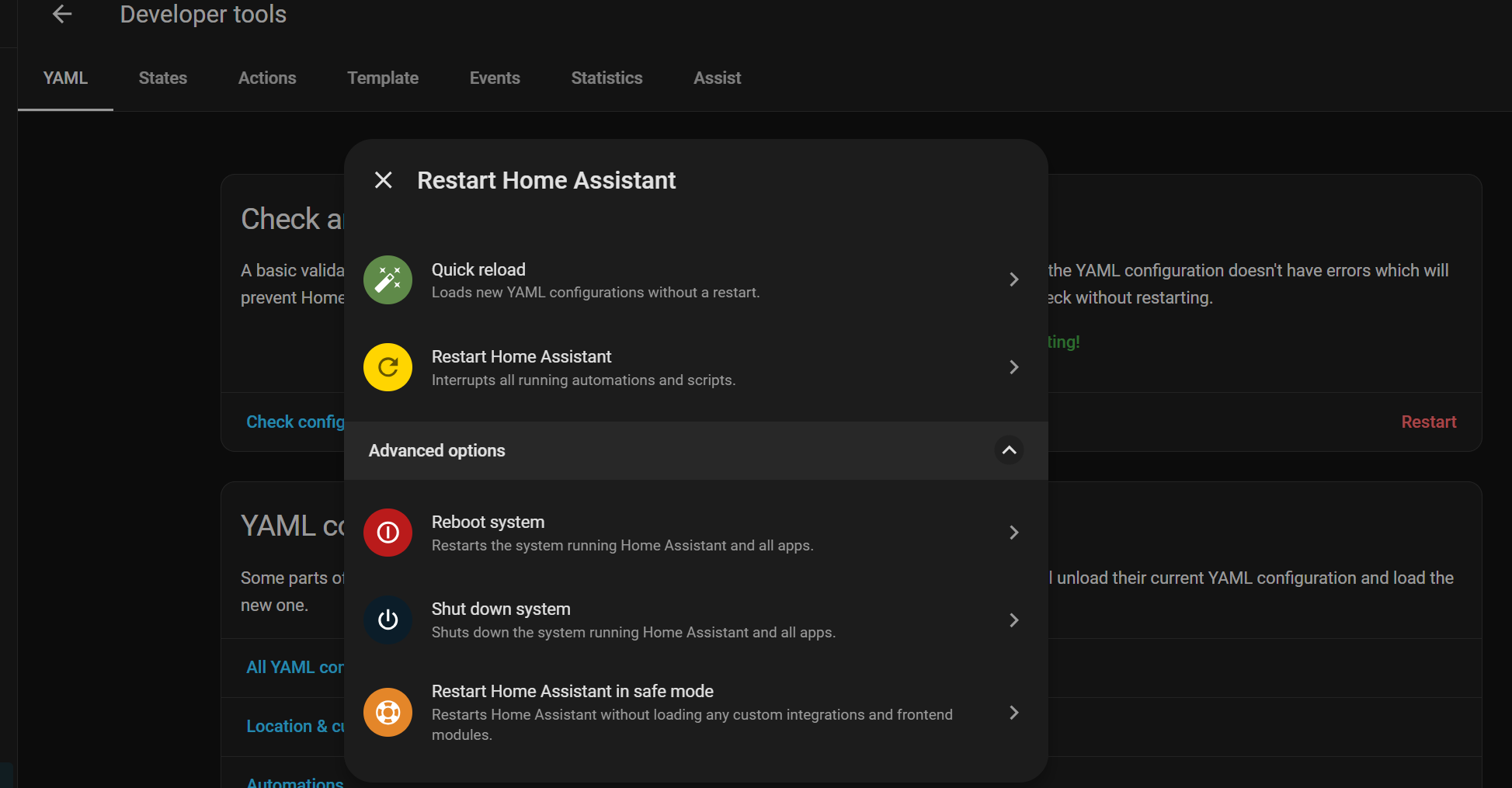

Last shot - try restarting in safe mode & see if they show up. Could be a custom integration messing with them.
I've no idea how to restart in safe mode - want to give me a pointer?
Sure. Dev Tools > Restart > Advanced Options > Restart Home Assistant in Safe Mode
Yep, done the safe restart - no difference to shrunken menu - so I've now done a normal restart.
