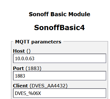

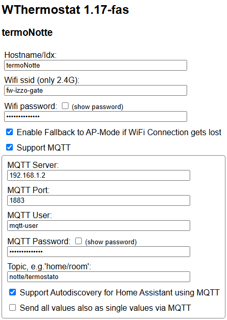

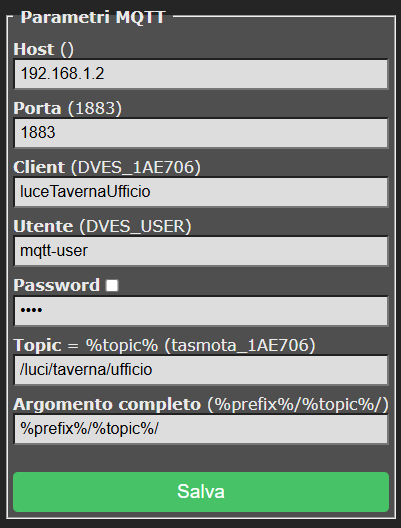

How are your Tasmotas configured ?

For completeness of information I attach the MQTT client configurations.

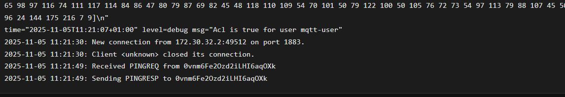

I’m sending you an update. The problem has recurred, and in the HA/Mosquitto Broker log I see the following message:
time=“2025-11-05T11:21:07+01:00” level=debug msg=“setting acl cache (granted = true) for mqtt-user”
From that precise moment, all MQTT devices lost connection.
Any suggestions?
