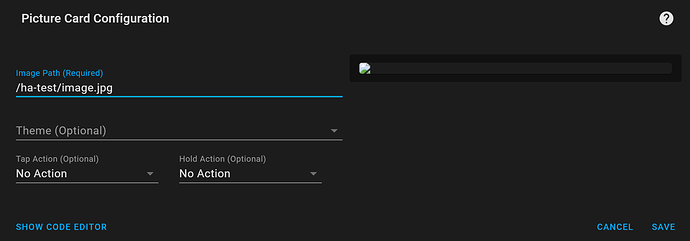

In an effort to greatly simplify this in order to pinpoint the issue, I did the following:
1 - Removed then installed HA docker with the option
-v /share/CACHEDEV1_DATA/Photos/ha-test:/ha-test
2 - Created a new folder and added a random jpg image in it
-rw-r--r-- 1 admin administrators 3912061 2020-02-07 21:22 image.jpg
[/share/CACHEDEV1_DATA/Photos/ha-test] #
3 - Added a Picture card and put /ha-test/image.jpg as the Image path
No edits to any of the configuration files.
Is this setup supposed to show the image?
Note that copying the file to /config/www/image.jpg and using /local/image.jpg as the Picture card path does instantly work
Thanks
