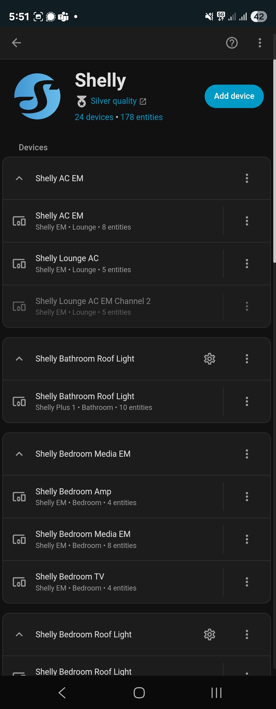

Taking inspiration from the Shelly Integration (screenshotted below) where a single hardware “Device” has multiple “SubDevices”. Perhaps policies could each be their own “SubDevice” under the Cat-flap Device?
Then for each of the SubDevices (policies) there could be a selector for “Entry Mode” and a selector for “Exit Mode”.
Options in each selector being “Full Lock”, “Full Unlock”, and “Microchip specific”.
Then each microchip the device knows about with be listed as a toggle. Toggled on would allow transit for that microchip when the selector is set to “Microchip Specific”.
