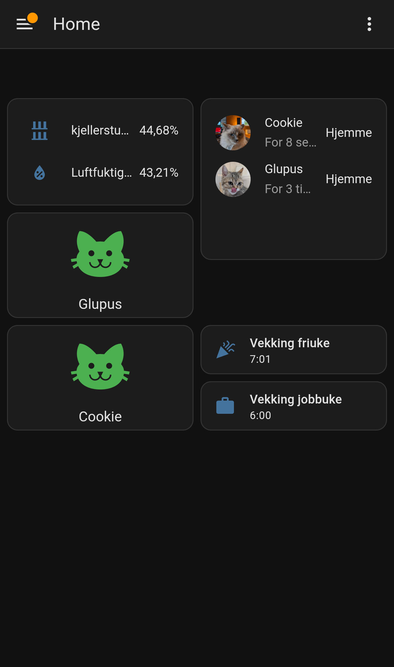

So what are you folks using for your cat based dashboards?
I’m not a dashboard kind of guy, while I still have one it’s more about function than looks.
the green cats in the screenshot are buttons to toggle their home state (blue when away) and is really the only thing I need cat-wise on my dashboard. I still have the other card with photos which tells me the time since the last state change.
I like that, what entity do you use for the button to say they have sneaked in?
I just use a regular button entity.
Here’s the relevant code for one of the cats, but I built the whole thing in the GUI.
          - show_name: true
            show_icon: true
            type: button
            entity: person.glupus
            tap_action:
              action: perform-action
              perform_action: onlycat.toggle_pet_location
              target: {}
                device_tracker: device_tracker.578098100863997_tracker
            icon: mdi:cat
