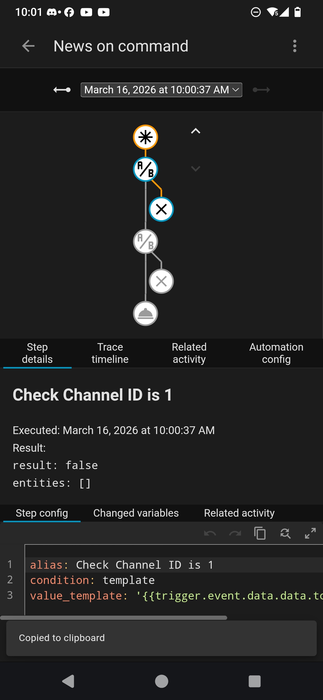

Idk why it didn’t work but I guess it was false somehow
alias: Check Channel ID is 1
condition: template
value_template: ‘{{trigger.event.data.data.to.channel == ‘‘1’’}}’
This worked

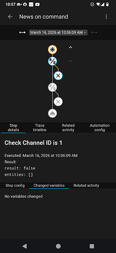

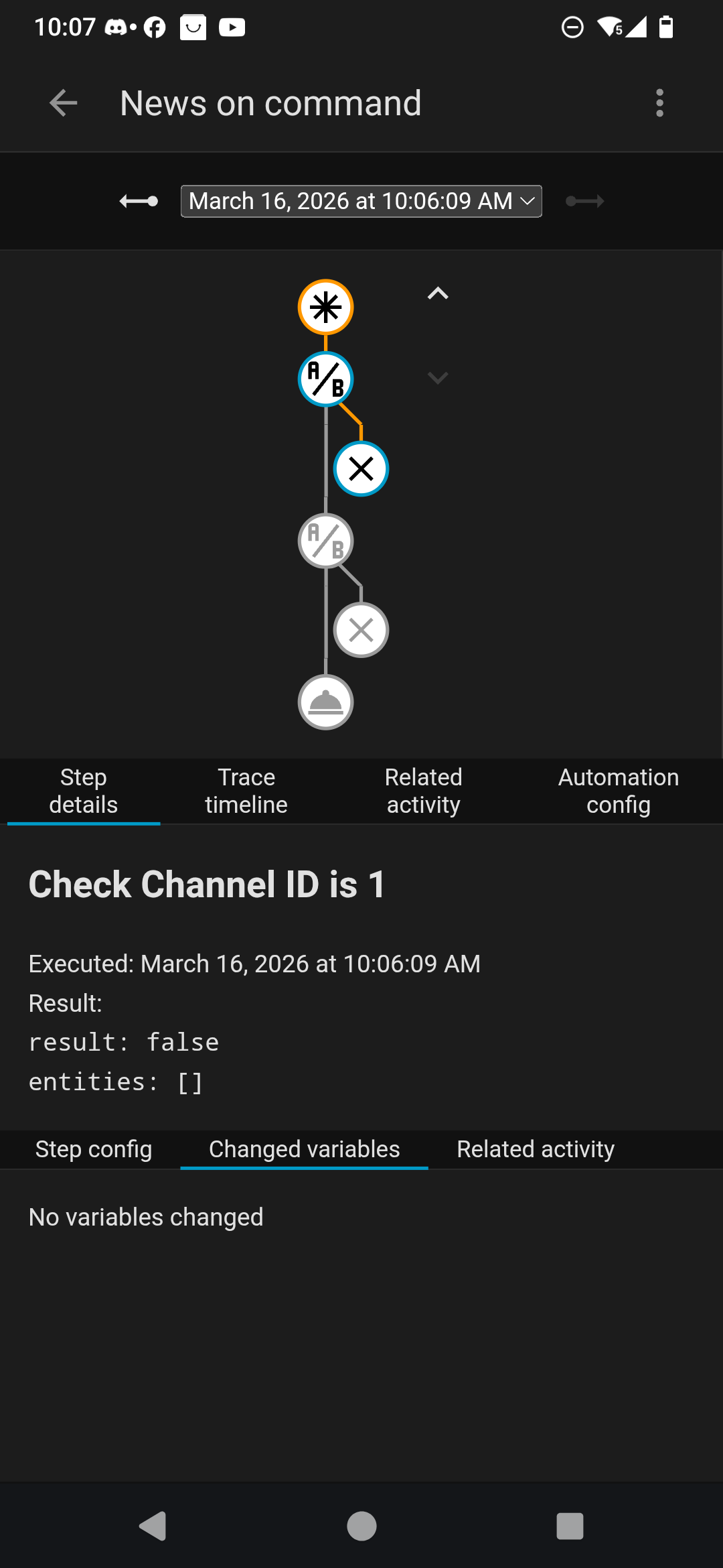

I just used “1” as an example, did you check that “1” is correct for the channel as it’s defined on your device? Check the “Changed variables” tab to see what the actual channel for that message was.
How do I do that
In the trace (where you took that screenshot) at the bottom there is a tabbed section that is currently showing “Step config” (as shown by the blue underline. Click on “Changed variables”.

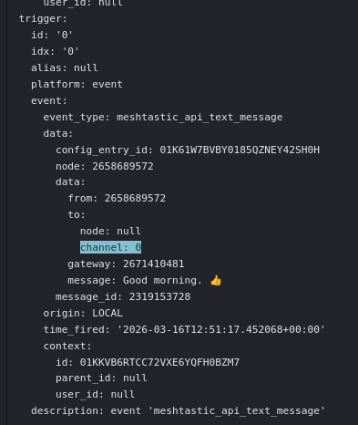

Then scroll down to find “channel”. Here’s an example from a message I received earlier:

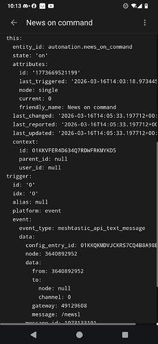

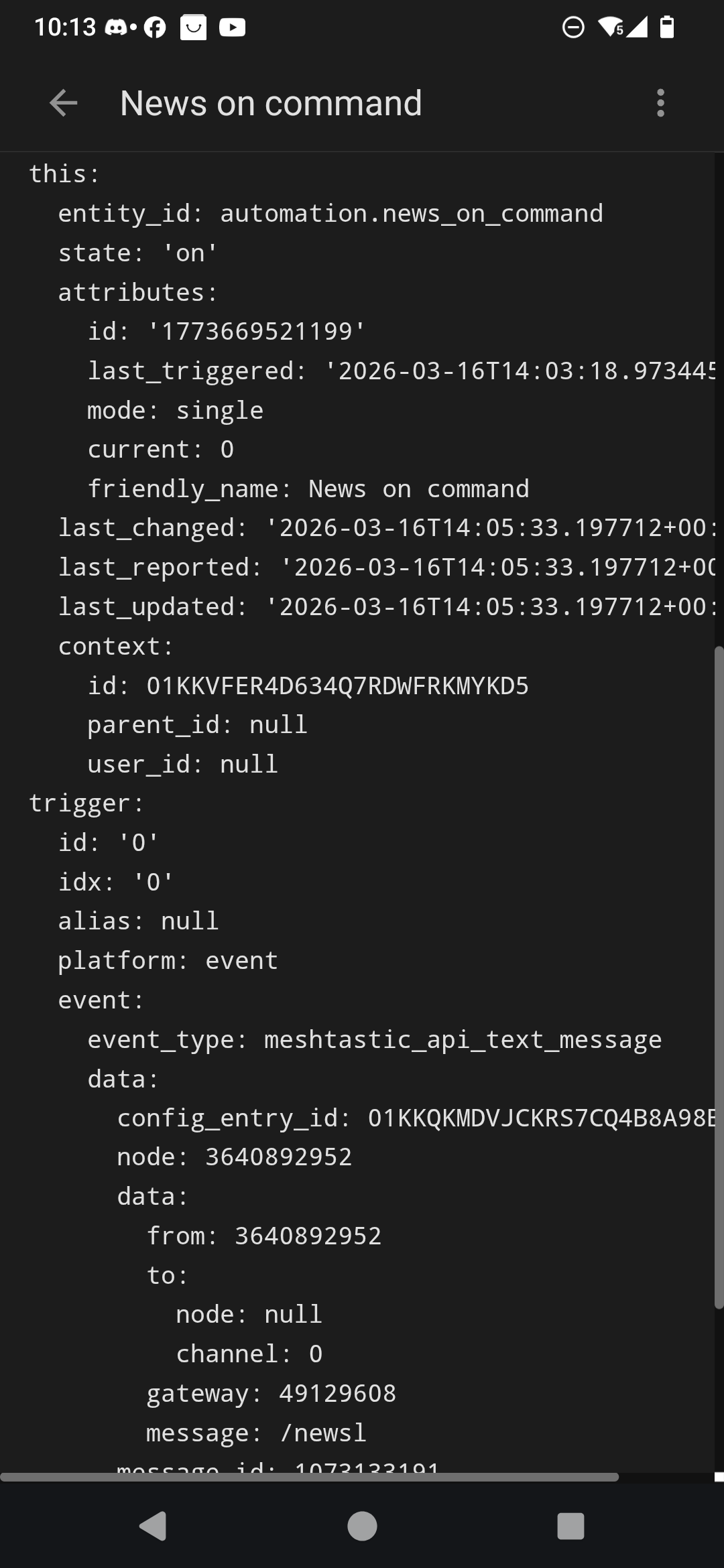

It’s empty
How do I see what the channel is called
You need to click on the trigger in the trace map… that’s the circle at the top with the asterisk-looking thing in it. Then select “Changed variables”.
1773669521199 is that it?
Oh wait no it’s 0
That message came in on channel 0. It comes in as a string, so make sure you keep it in quotes (like I had it in my example) in the template.

Try it without the quotes around 0. The trace doesn’t show it as quoted, so I may be mis-remembering something I did with mine…
EDIT:
Just tested, it should be 0 not “0”. :man_facepalming:
