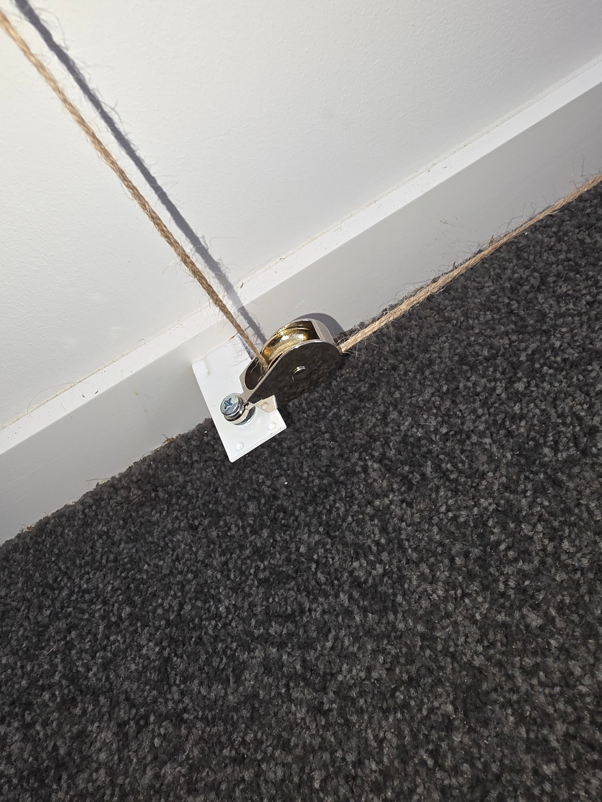

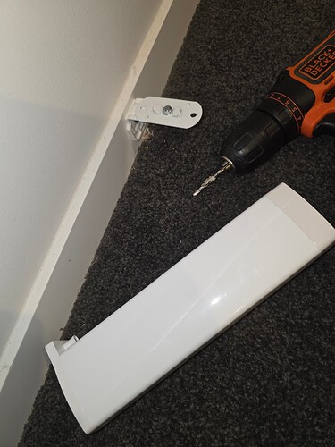

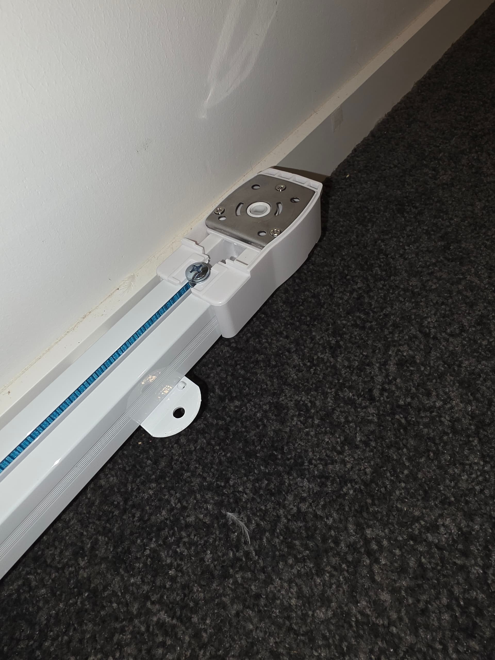

We have heavy material roman blinds installed by Harvey Furnishings. I spent time thinking about how to automate them because I couldn’t find any other solution. It takes a great deal of force to pull them up. I actually bought a grunty servo and controller and started to design a solution using ESP Home but it was just too hard.
Then I automated a standard pull curtain on rails using a Tuya Curtain motor. This was tricky but worked really well so I wondered if I could repurpose the Curtain Motor to open and close the blinds. I had some aluminium track and other parts left over and bought another Tuya Zigbee Curtain motor.
I thought that I would need some form of block and tackle to have enough force to lift the blinds but initially just bought a pulley. Then I used a spare section of the aluminium track and the associated curtain track fixings to come up with this Heath Robinson solution.
https://youtube.com/shorts/uhEs2lSSx-A?feature=share
It is (more or less) hidden behind a bed and works well. The motor has decent holding power to keep the blinds up.
I have set up morning and evening automations to open / close the curtains and blinds, turn lights off / on and play the radio.
My best HA project to date.
Total cost about NZD100.
These motors could be used in all kinds of ways as they are very strong, the fittings are readily available and they integrate well with HA / Zigbee / Alexa etc. I could see them opening and closing shutters and even windows for instance. Note that newer (but more expensive) motors are available that are shorter and there are battery powered versions.

Effort vs time vs difficulty. For instance I was concerned that the servo would slip and not hold the very heavy blinds at the top of the travel. I was also going to have to track the position of the cord / use some sort of endstops. I bought servo controllers that monitor current use and can signal when you are at the end of the travel but I couldnt work out how to integrate with ESP Home etc. Anyway gave up on using discrete parts and very happy with this. $60 for all the electronics is cheap.
the motor you linked only has 1.2Nm torque where that round pancake motor has 5Nm torque although i don’t blame you i once used a zigbee water stop value to do a similar thing, using it to open and close a door / flap under the kitchen units for a robot vac because it gave me everything i was after in one ease of package
before fixing / hinge bound
