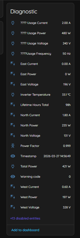

Does anyone else have a Goodwe Solar Inverter that’s missing some data in the Home Assistant integration? We have no grid import, export, or total power usage. They are present in the SEMS API integration but unfortunately the API is deprecated in May (maintainer is working on a solution).
We also can’t figure out what the ??? sensors refer to. They originally said Grid L1 or something similar, but are definitely not the missing sensors.
Nothing a bit of pressure on them to release the API documentation wouldn’t fix.
Guessing and reverse engineering to extract valid data is obviously a pain.
This is why I recommend avoiding GoodWe inverters - their hardware is robust, but their software interface is very poorly documented.
Try the HACS goodwe integration as it is often a bit more up to date and my goodwe shows a lot more sensors using it than your picture shows.
Thank you!
Worked even better than I expected. Heaps of bonus entities.
