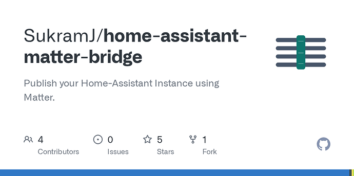

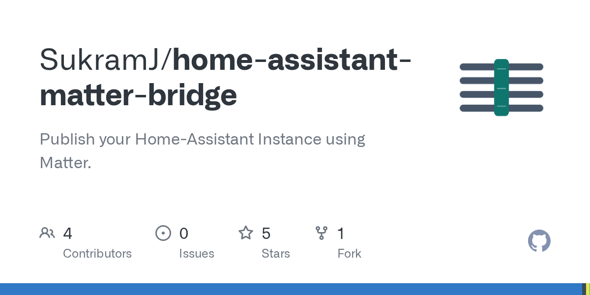

My solution: Home Assistant Matter Bridge
I found Home Assistant Matter Bridge by SukramJ:
The project allows Home Assistant entities to be published to Matter-compatible ecosystems such as Alexa, Apple Home and Google Home.
