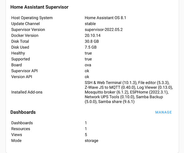

Are you positive about that? I also had HA OS 8.1 offered for install this morning, and it looks like it is production/stable if I’m reading this screen correctly:

However my sensors say :confused:

Sounds like someone forgot to update the release notes, unless they did some sort of limited release to production and/or backed it out shortly after release due to a huge bug???
Dunno. I’ve asked.
Ok, it has been purposely moved to stable:
