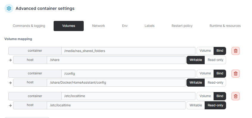

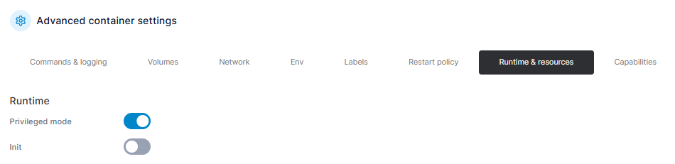

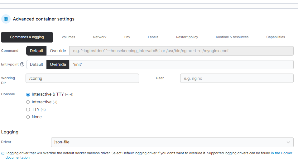

my container settings in screens:
just latest tag and network ‘host’
entrypoint override (not sure this is needed)
few binds:

Also struggle with my zwave stick. Container is just not getting the serial access. acces right issue, for now solved with privilieged container on ZWJS
