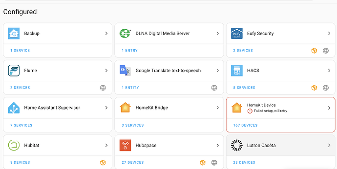

Turns out the HomeKit Device integration was failing, and after looking into it, one of my Ecobee thermostats kept causing issues, so I disabled it. The TP-Link integration was also failing because one of the smart plugs was no longer reachable—I had replaced it with a Zigbee plug. After removing both, the file descriptor count is now at 439. I’m currently monitoring to see if it remains stable.

Mine didn’t happen since I completely disabled “HomeKit Device” & also when I removed the unreachable TP Link device which was using “TP Link Smart Home” integration.

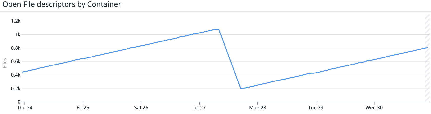

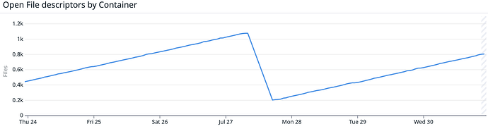

Not sure TBH, As far as I understood, developers plan is to raise limit to 2048 in one of the next updates. Personally, for the time being, I have rolled back to OS 15.2 where the fds were not limited. It seems like, at least for me, there is an fd leak somewhere : im monitoring the number of used fds and it keeps increasing steadily, not sure which part of my setup is causing this at this point.
Here’s my graph for open fds for the ha container, definitely doesn’t seem healthy :slight_smile:
Can you explain how you are monitoring open file descriptors?

Oh I’m using datadog (http://www.datadoghq.com/) with a free trial account => I manually installed the datadog agent as a docker container on the home assistant OS, it collects a number of metrics and one of them is the number of open fds per container. Graph is done using the datadog web dashboard ui.
