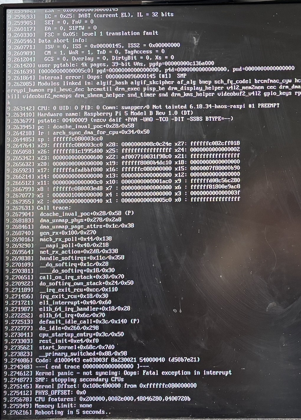

Booting always fails with a kernel panic (see attached image).

I see error EC = 0x25: DABT (current EL), IL = 32 bits at the top. I think your Intenso Premium SSD 256GB (separately powered using USB Hub) is the issue.
  1. Is it listed as a compatible with Raspberry Pi devices?
  2. Is the drive attatched via a USB 2.0 or 3.0 port?\

The drive is attatched to the blue USB 3.0 port of the PI 5.
I tried leaving out the USB 3.0 hub and connected the drive directly to the 3.0 port on the PI 5. The result is the same.
Since the Pi OS is booting fine, I am reluctant to believe there really is a hardware incompatibility.
Search Raspberry PI Intenso Premium SSD known issues.
This search did yield an interesting result. According to this list (german raspberry pi forum):
My device is in the middle category of “needs usb storage quirks”.
1.d [152d:0579] JMicron 3.0 [Intenso] M.2
Still puzzling that Pi OS boots fine.
Tested booting the HAOS version on the USB 2.0 connector. It does not crash at the same step and proceeds to load different modules. It fails / freezes at a later point though.
There are still things I can try so I will exepriment more.
Agreed, not crashing at the same point indicates you may be on the right path. Quirks or Power related…
