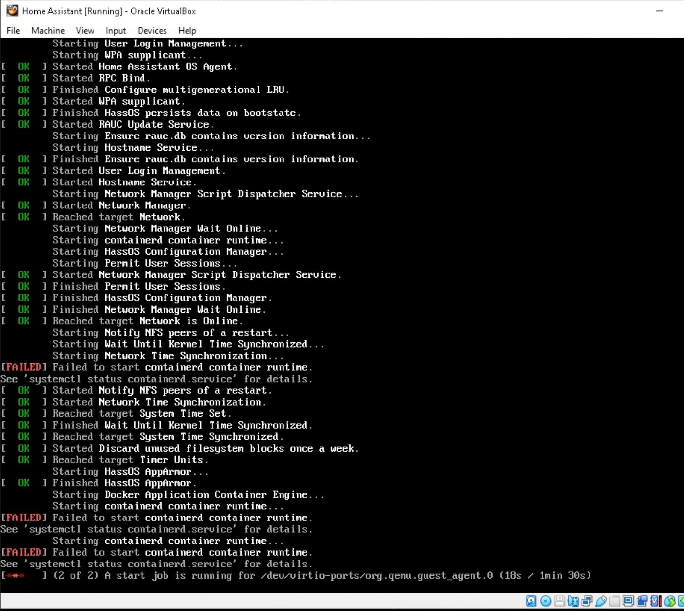

I’ve been running my Home Assistant install in VirtualBox since 2020, never really had any major issues
But my Operating System is stuck in version 15.2
Whenever I go to upgrade the system reboots a couple of times and it gets reverted back to 15.2
How do I fix this?

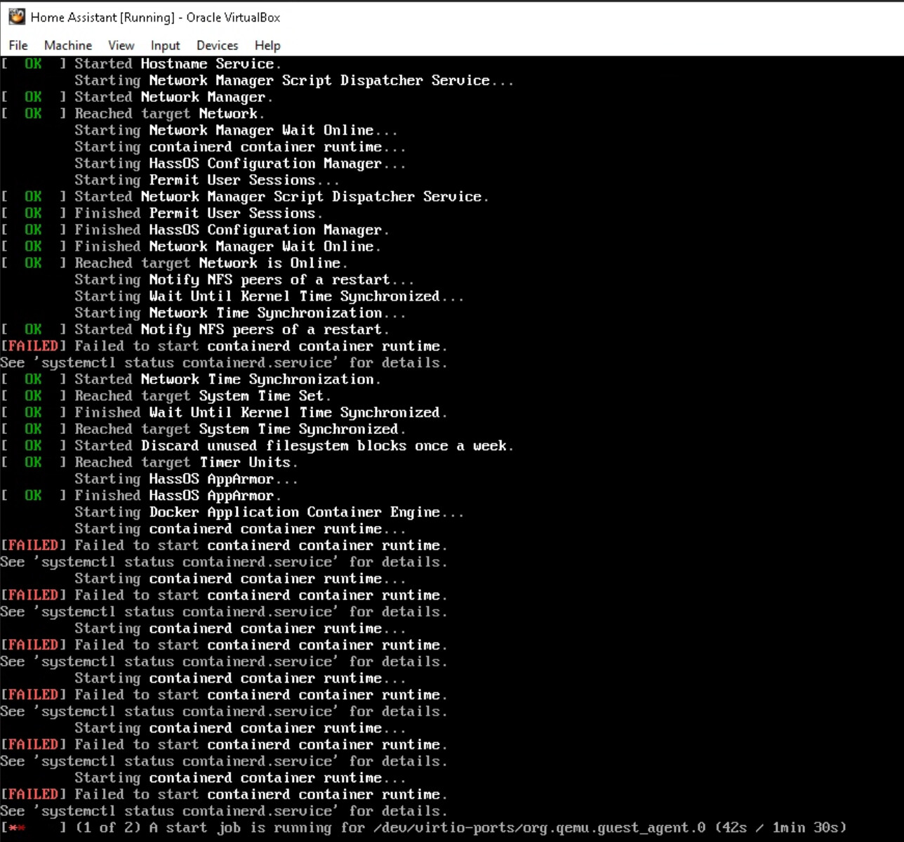

This has been happening since 16.0 came out, so at least a couple of months
I rebooted the system many times, always the same result
I just did ‘HA OS UPDATE’ in cli - same issue on reboot :man_facepalming:

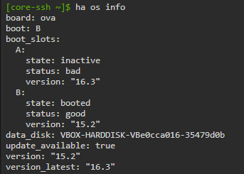

Try some of these suggestions. Put this in a search engine for posts about bad boot slot.
site:community.home-assistant.io boot slot

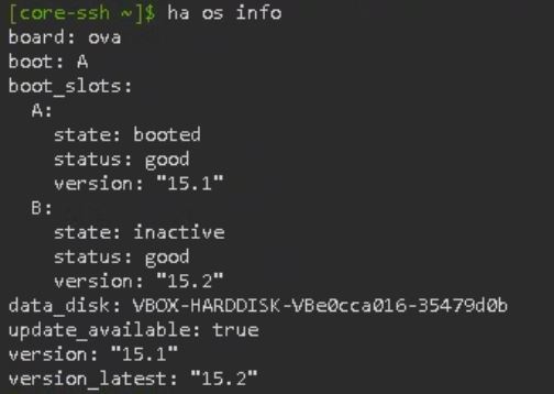

Yeah I don’t think it’s a problem with the slots
I did a ‘ha os update --version 15.1’ and the downgrade completed successfully
The I tried to update to --version 16.0 and I got the same boot errors as in my original post
It tries to boot 3 times and changes back to the last good working slot
Something must have changed between versions 15.2 to 16 and up for VirtualBox ?
From what I’ve seen ‘QEMU Guest Agent’ isn’t supposed to be used with VirtualBox anyways?
