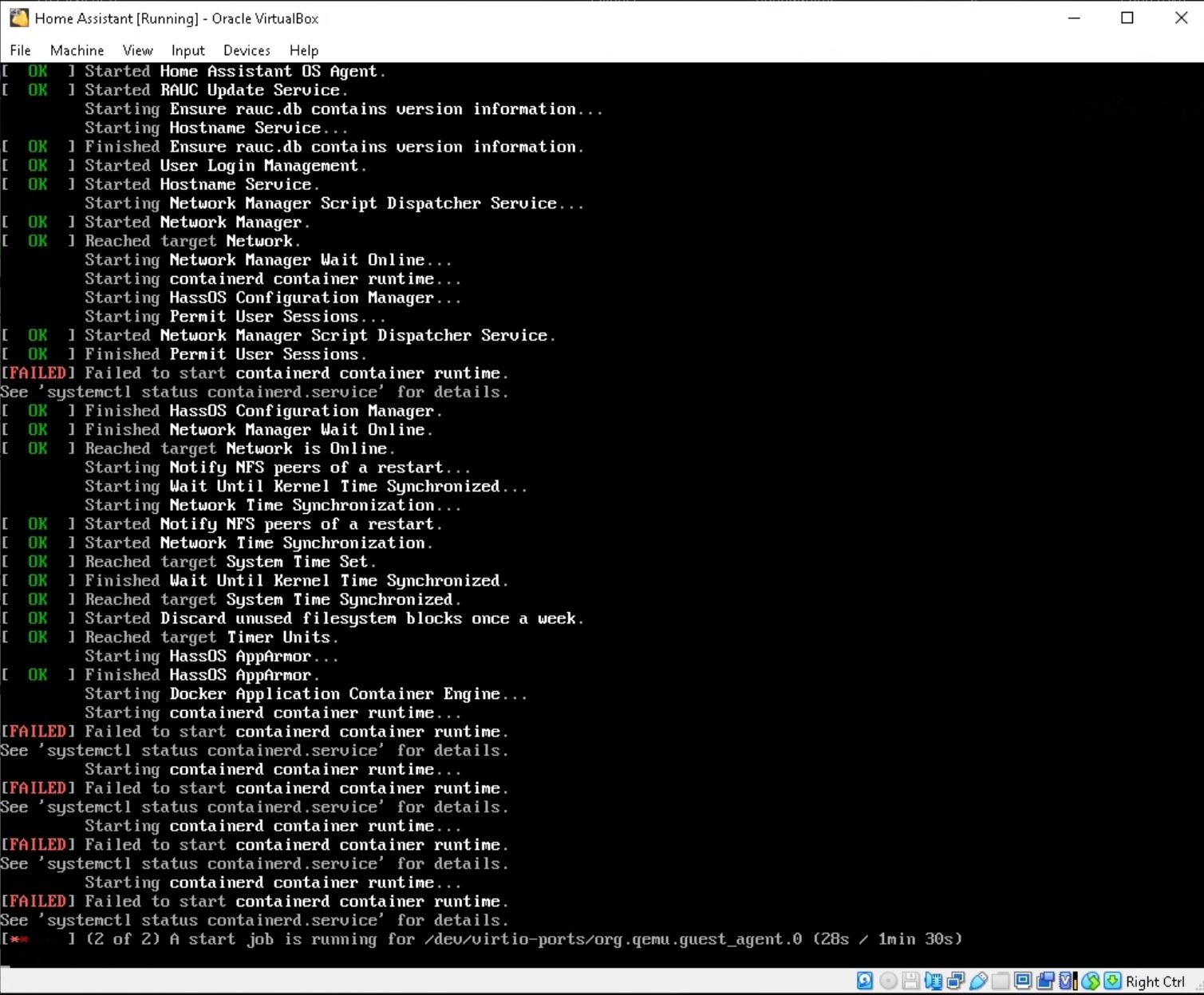

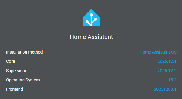

But my Operating System is stuck in version 15.2
Whenever I go to upgrade the system reboots a couple of times with the error and it gets reverted back to 15.2 every time I try
How do I fix this?

OK, that log kept talking about container so it seemed different from what I know.
There are 2 slots for the supervisor. When you update it updates the one you are not using, then makes 3 attempts to switch to it. If it fails, it goes back to the working slot.

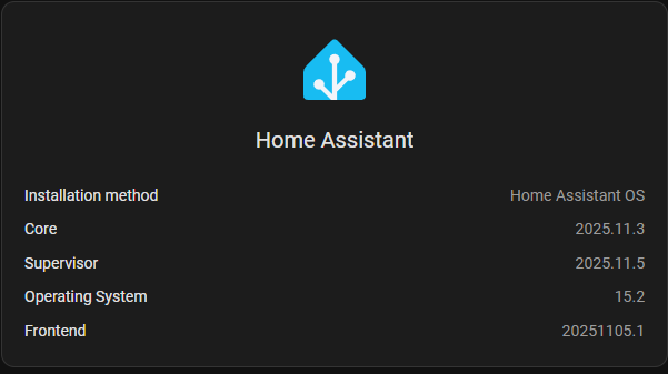

I’m having the same problem also with 15.2 but not no a VM. I have a dedicated x86 machine running HAOS and haven’t been able to update. I’ve restarted HAOS as well as rebooting the computer.

Just found the solution at HAOS Stuck on Version 15.2 - #3 by Dazlindazza
It didn’t work for me, still stuck on 15.2 :man_facepalming:
