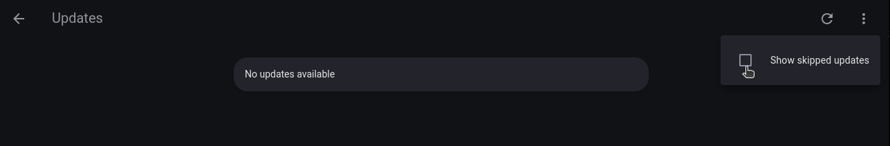

Also make sure to check that you haven’t skipped the updates.
From the Updates menu click the breadcrumbs in the top right and check “Show skipped updates”.

Already done, nothing skipped.

@christcb can you share how you solved the issue?
i am stuck in the exact versions that you opened this discussion with (core 2025.6.1 etc.). HA does not see any new updates.
I’d follow the supervisor logs via ha supervisor logs -vf and then run
ha refresh-updates
ha available-updates
Check for any errors or warnings in the supervisor logs.
I ran the update command from the CLI. The command was just ha core update. After that it has been working normally.
