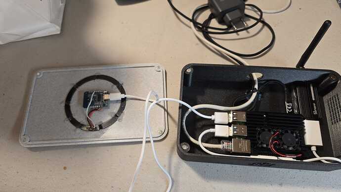

Hi, I just recently build my HA Server, designed and 3D printed a case for it, and added a D1 mini with LED ring running WLED inside the enclosure.
I want to use that D1 mini to “show the status” of my HA server, like this
(I have the “scenarios” i want in presets in WLED)
If nothing happens the Led ring just fades and comes back
If HA Discovers a new device or needs an update (notification) then switch to the notification preset until i do what’s necessary
If there’s an error, Solid red preset
When i do something like turn a light on or off, or if an automation starts, the i want a small “loading” bar
ETC…
I didn’t find anything online, so I’m asking for your help here, if someone can help me.
See Pictures…
sorry new user, can only post 1 image
