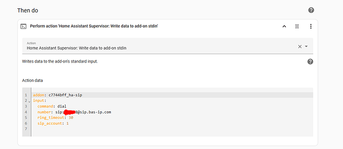

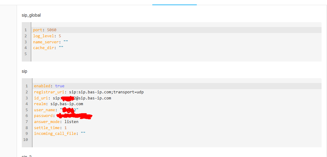

I have successfully installed it, I am trying to use it for BAS-IP to be able to make calls from assistant to my Intercom and vice versa, these are my configurations:

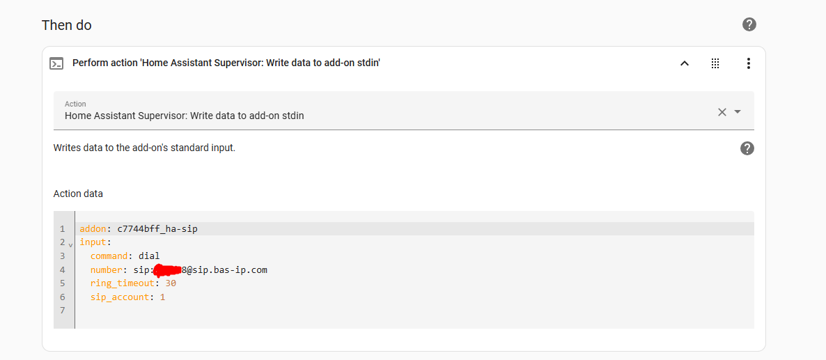

and I have this automation with an action to be able to make an outgoing call:
from the addon logs, everything seems fine:
but I am not getting a call to the number I am trying to call, I have a sip client installed on my laptop but didn’t receive a call. What am I missing?
