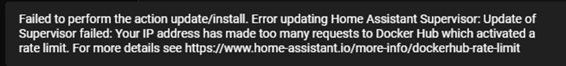

I had an update for Home Assistant Supervisor 2026.3.3 pop up this morning and I’m not able to install it. I installed my Home Assistant on a mini-PC running the Home Assistant OS. Does that use docker? I’ve never seen this error before.
The first error I received was this:
I then followed the instructions found at the URL Docker Hub Rate Limit - Home Assistant and set up a docker account.
In those same instructions are two different registry entries in the text is says to enter docker.io and in the image it has hub.docker.com - I tried them both with the credentials that I created for my docker account.
I’m now receiving this message:

Looks like the site itself is overloaded, as everyone tries to update at the same time.
Just try again tomorrow :wink:

This may help if you have a Docker Hub account to use. It worked for me.
No, Supervisor is the only part of HA which updates automatically. That is why you were seeing the rate limit (everyone’s instance was trying to update & your instance was probably blocked temporarily after x retries).
By leaving the update alone for an hour, your rate limit cleared & Supervisor updated by itself.
TLDR: There’s no need to update Supervisor manually - it’ll happen automatically when it’s good & ready.
