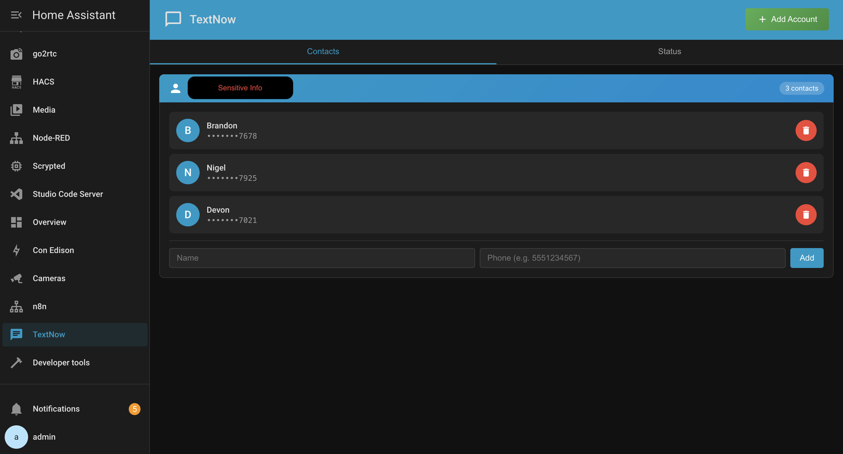

  • Contact management via UI

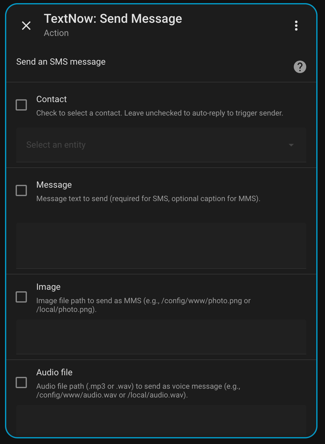

textnow.send - Send Messages
Send SMS, MMS (images), or voice messages.
Fields:
  • Contact - Leave unchecked to auto-reply to trigger sender, or check to select specific contact
  • Message - Text content
  • Image - File path for MMS (e.g., /config/www/photo.jpg)
  • Audio file - File path for voice message (e.g., /config/www/audio.mp3)

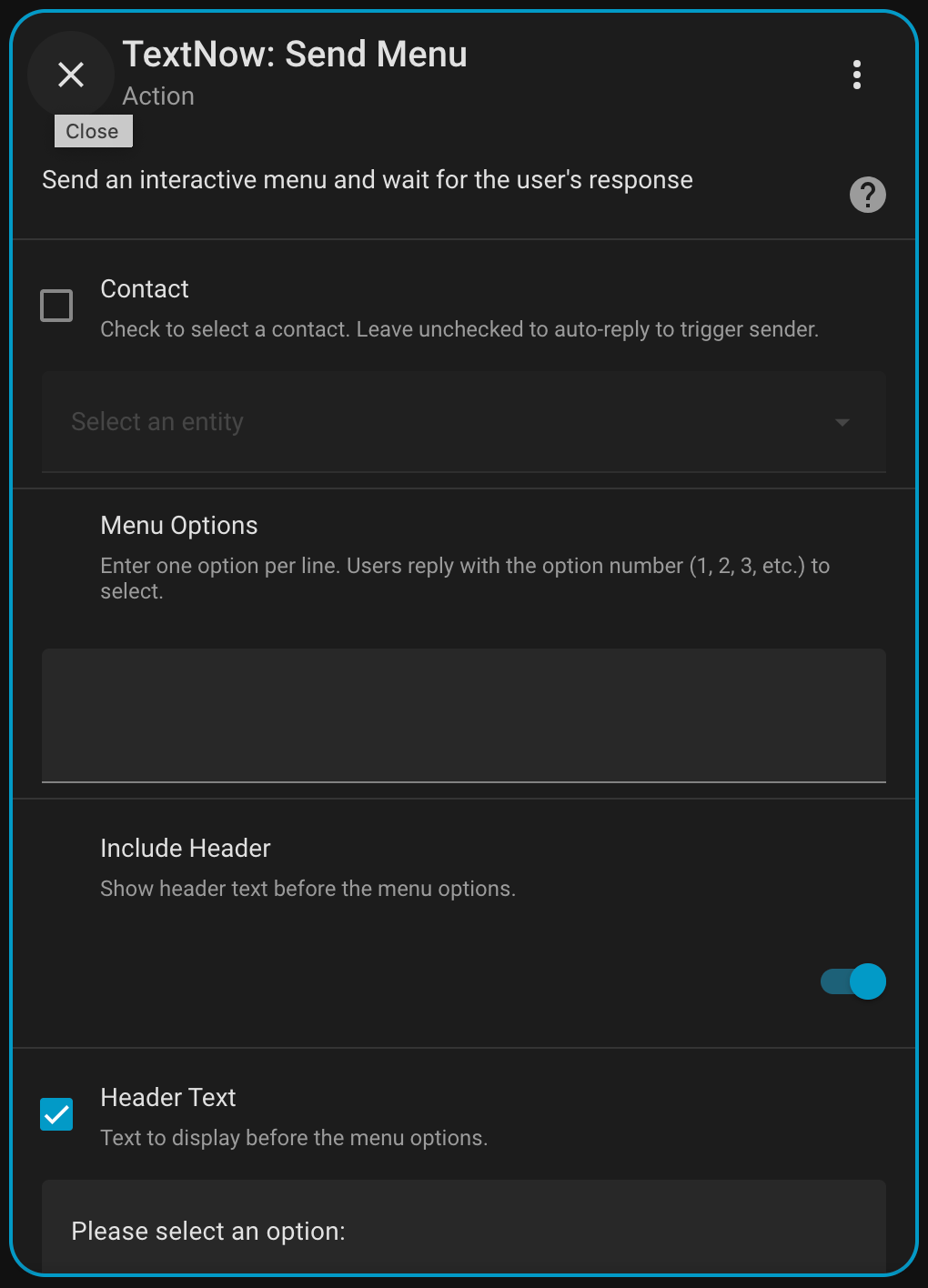

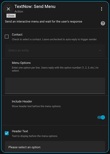

textnow.send_menu - Interactive Menus
Send a numbered menu and wait for user’s response. Perfect for interactive control!
Fields:
  • Contact - Leave unchecked for auto-reply, check to select contact
  • Menu Options - One option per line
  • Include Header - Show header (default: on)
  • Header Text - Custom header (default: “Please select an option:”)
  • Include Footer - Show footer (default: on)
  • Footer Text - Custom footer (default: “Reply with the number of your choice”)
  • Timeout - Seconds to wait (default: 30)
How it works:
  1. Sends numbered menu via SMS
  2. Waits for user to reply with number
  3. Returns response as variable
  4. Continue automation based on choice
Response variables:
  • choice.option - Selected number (1, 2, 3…)
  • choice.value - Text of selected option
  • choice.timed_out - True if timeout

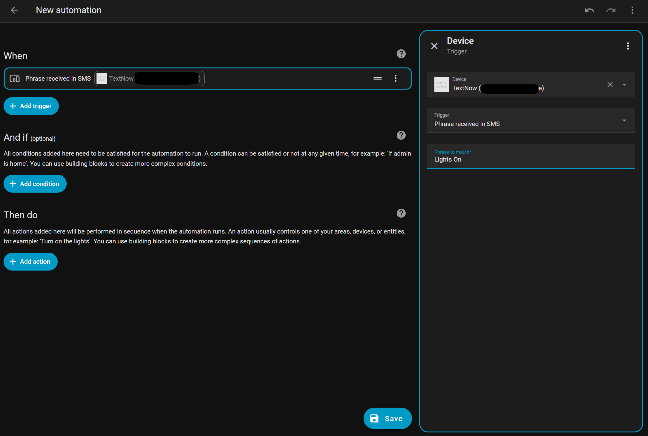

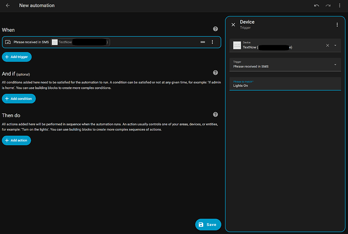

Phrase Received in SMS
Fires when message contains specific phrase (case-insensitive, matches anywhere in message).
Setup:
  1. Add Trigger → Device → TextNow → Phrase received in SMS
  2. Enter phrase to match
Variables:
  • Same as SMS Message Received, plus:
  • {{ trigger.matched_phrase }} - The matched phrase

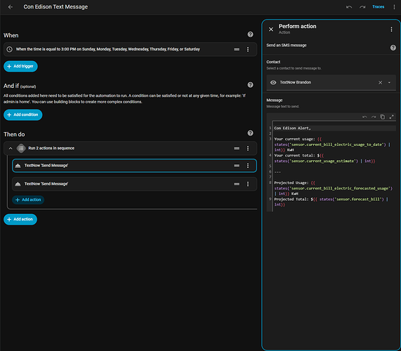

Heres a sample automation i have to send me text message of my current electric bill usage
I thought this would be more wanted :sweat_smile:

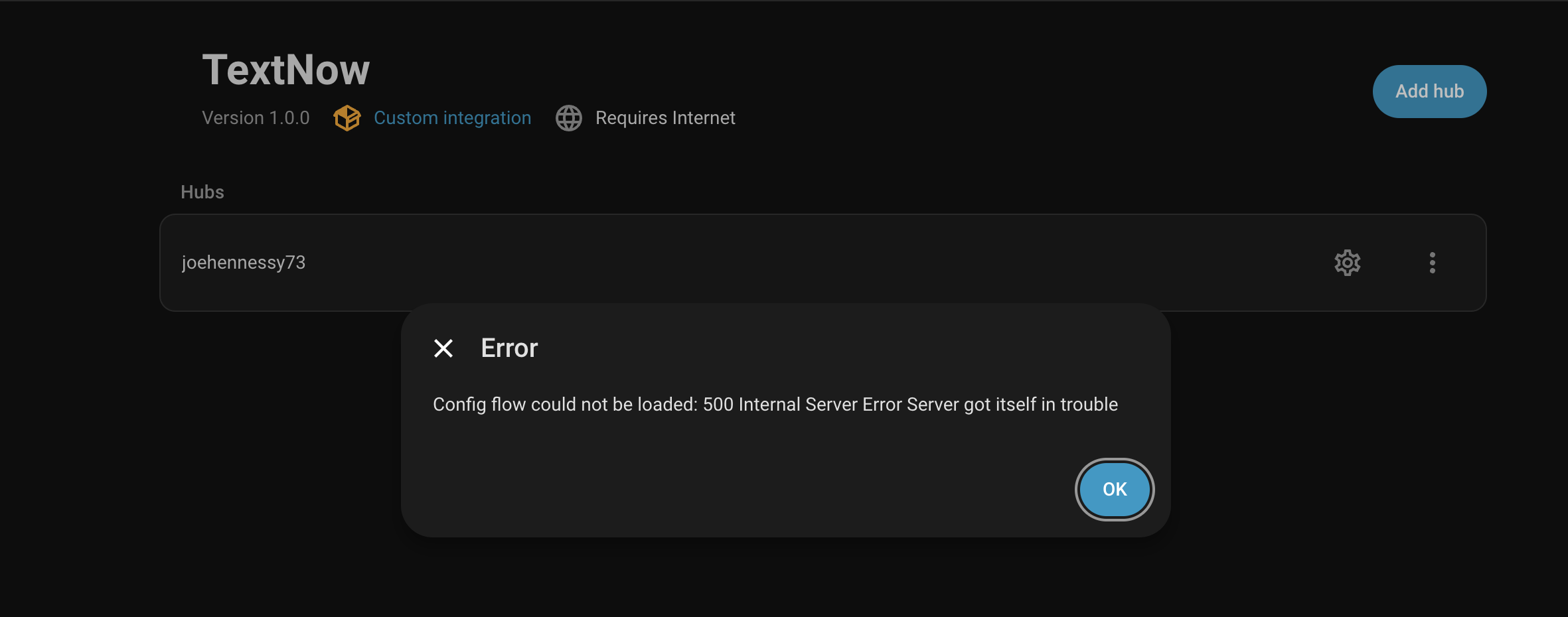

I have tried a dozen times, and double checked I was doing it correctly, to configure the link and it will not work. I’m getting the error “Config flow could not be loaded: 500 Internal Server Error Server got itself in trouble” when trying to access the settings/cog wheel.
i have to update the integration gonna be a while my apologies (im facing the same thing)
Repo deleted ;( Interesting project, i wan’t this in my HA :smiley: Need some help with this?
@patryk0802 @JoeHen GitHub - zodyking/Home-Assistant-TextNow: Home Assistant custom integration for TextNow. i fixed it, its working again.

Also if you update your integration you’ll see some new features:
2 new device triggers Texnow sms received & Textnow phrase received
1 new action Textnow send menu.
Summary you can now send menu’s and respond to them interact with to as run automation by sending a phrase “Lights” and a menu sends to the contact with various options (yes this automation flow allows for sub menus) Personally i use it to allow roomates to request ConEd account related things :slight_smile: there will be more updates to further increase the ease of automation

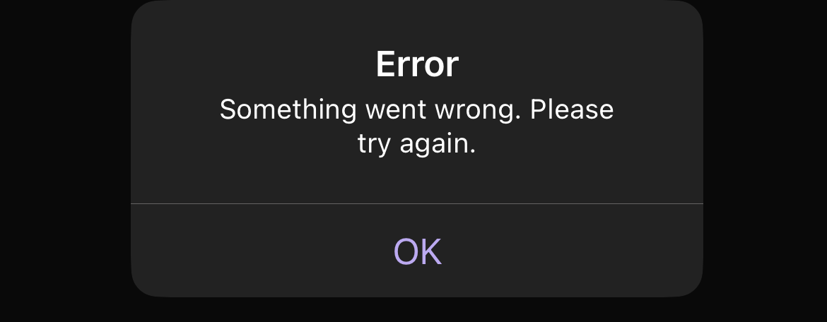

Haven’t had any luck signing up with TextNow to try this out.
Is that a screenshot of textnow, if so siqn up via pc not on phone. That part i cant help with too much but the intergration side i can (which is fully working)

Also i havnt used this with node red, the unofficial api can get any inbound or outbound communications however for sake of how i intended to use the integration/security purposes i limited it to only the numbers registered as contacts because the integration allows you to create sms based triggers to run automation in your home.
The triggers run against all registered contacts, instead of just anyone who text the phrase to the text now number.
