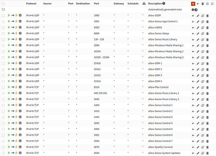

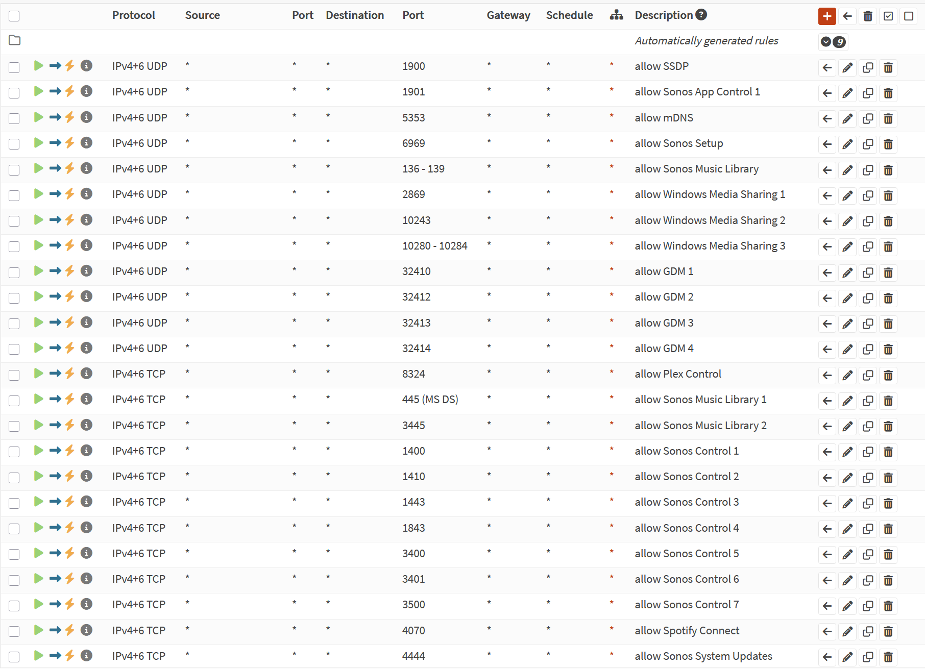

I’ve got a bunch of Floating Firewall Rules for various multicast ports:
Am I missing any for the websockets for HA?

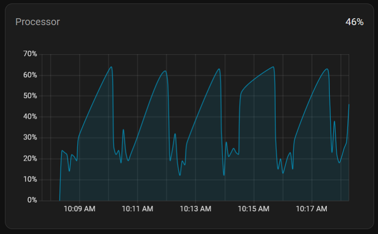

I am running Home Assistant 2025.9 in host networking mode. The web ui will work for 30-50 seconds then become unresponsive. The message “Connection lost. Reconnecting…” appears on the UI and 20-30 seconds later the page is responsive again.
Getting very odd spikes between resets too:
