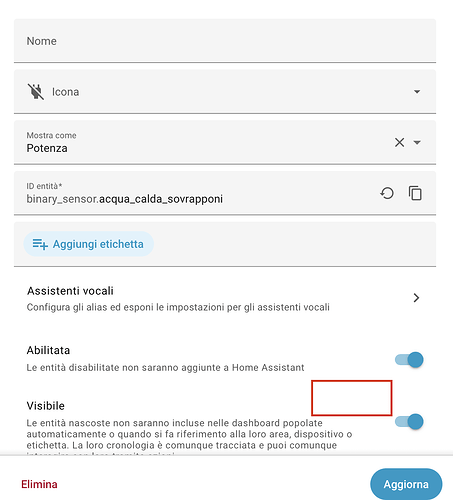

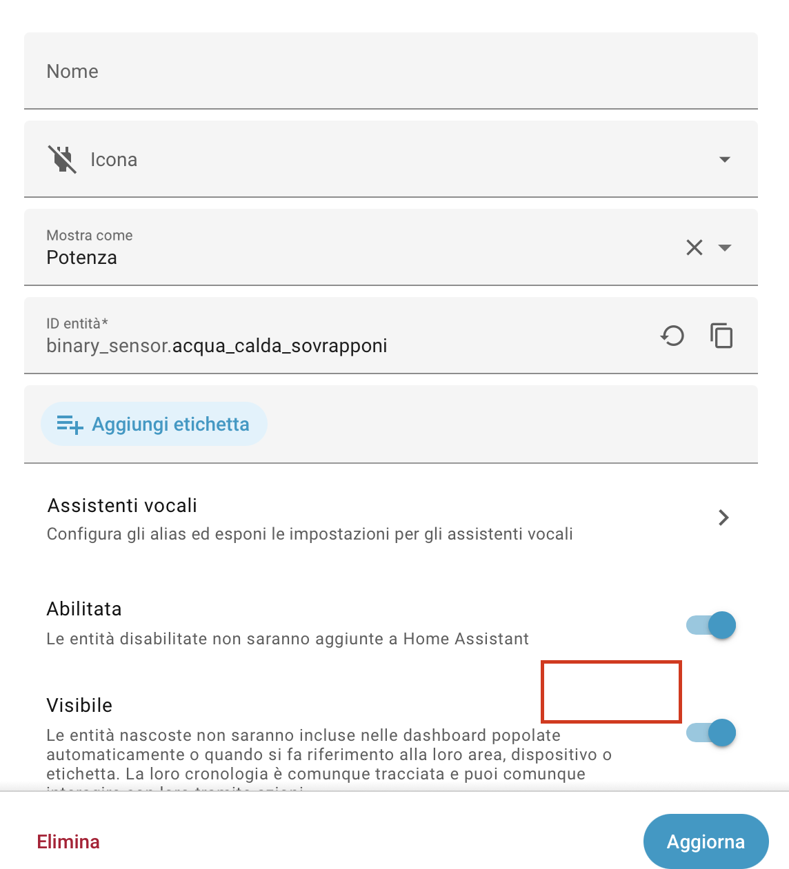

I can delete them, right?
I deleted that rule from my UniFi a few weeks ago, and I reload it often in HA since I’m quite a novice.

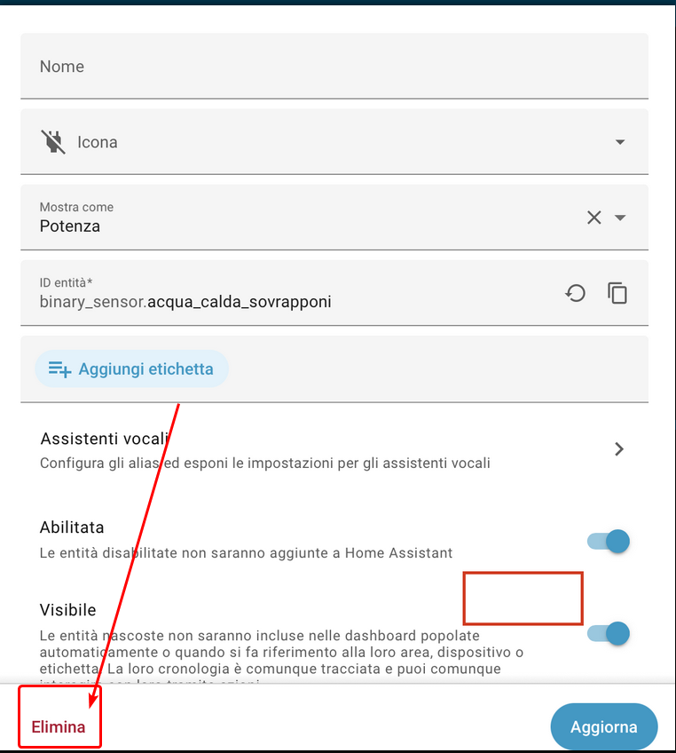

By delete, do you mean this? (example… in red)

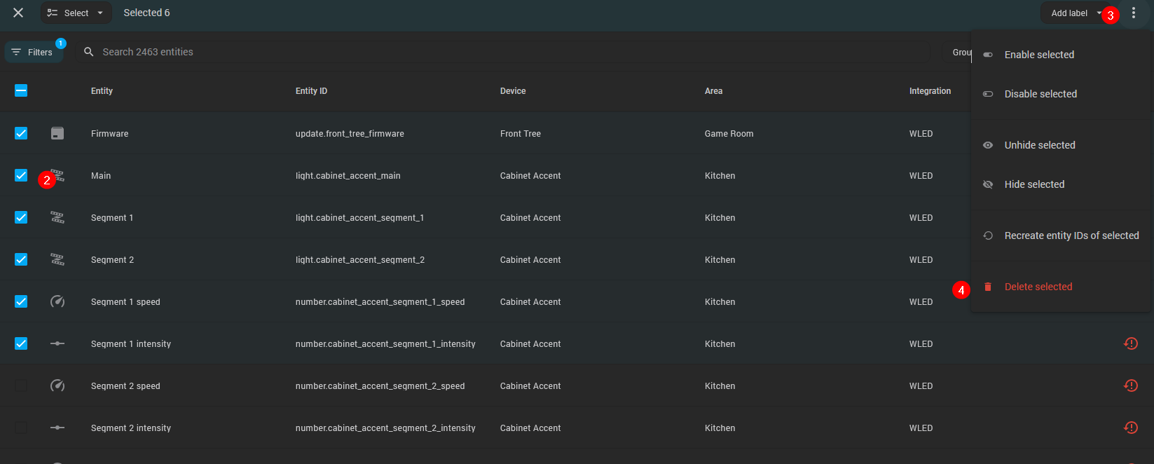

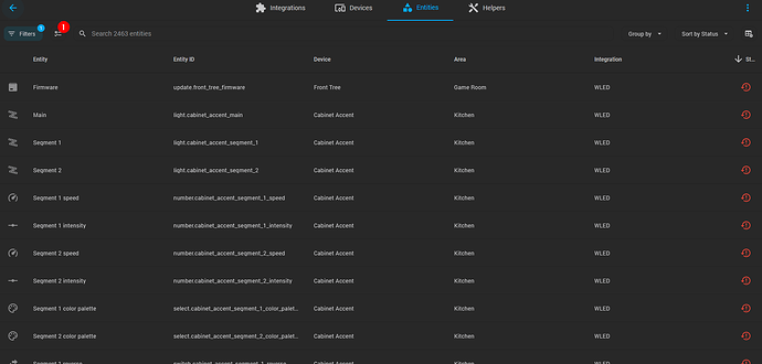

for mass delete:
yes… sorry… I have insert a square not in the correct position… :sweat_smile:
