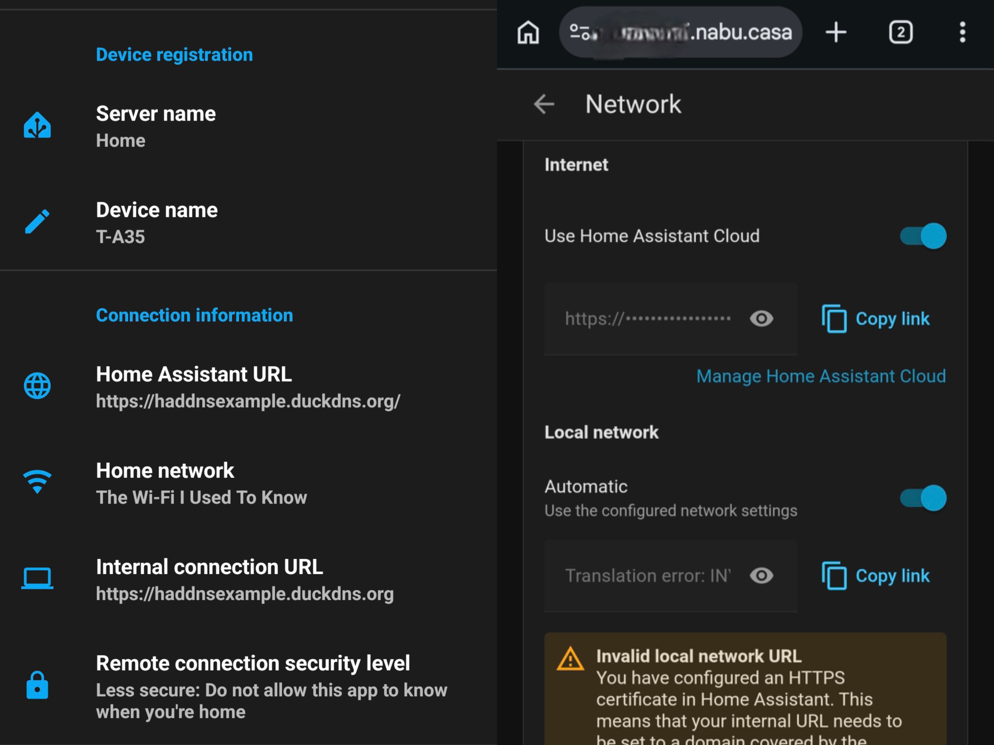

I flashed my HAOS onto an laptop I was no longer using. I’m using HA companion app for Android to connect. I signed up for the free month of Nabu Casa’s Home Assistant Cloud service just a few days short of a month ago. Since then, in an attempt to fin an alternative solution that would enable me to be able to connect to my HA instance will away from home. I downloaded and set up both Duck DNS and WireGuard with/on my HA. Which worked fine for a few weeks until I had to leave the laptop I’m running HAOS on unplugged for long enough that the the old battery died inside. By the time I was able to plug my laptop back in and turn it on, HA had rebooted and I lost my ability to access it. I followed some instructions from Google Gemini on how to reconnect. Which I was thankfully able to. I’m learning more and more that it’s unwise to just blindly trust LLM’s advice. As it had told me to use duck DNS domain name (https://haddnsexample.duckdns.org) to fill in both “Use Home Assistant Cloud” and “Local Network” section under Network > System > Settings in my HA instance. As well as “Home Assistant URL” and “Internal Connection URL” under Connection Information > Server > Services & Devices > Companion App in my HA app. I had a gut feeling that this didn’t make sense. However, I just went with it because it worked at the time. I also set up WireGuard in HA that am using with my phone. Google Gemini’s instructions seemed to get the job done there as well. However, when I was unable to connect to my HA instance after reboot. Nothing I had set up was allowing me to regain access. Now that I’ve explained why I’m asking the question. It’s finally time for the question itself.
I’ve included two screenshots of my HA Network page and my HA companion apps “Connection Information” page. I was wondering if anyone could explain what these are and advise me on the correct addresses need to be entered into them in order to give me local access to my HA instance while home and using Duck DNS as the secure way to access my HA instance while I’m away from home. Also, I’m a little uncertain about how WireGuard works with HA. I’m familiar with WireGuards implementation as a server within my router which allows me to access my router while I’m away from home. However, with Duck DNS acting as a secure https connection to my HA instance. Wouldn’t the implementation of WireGuard as a server within HA also be allowing me to access my HA instance securely while away from home? If so, would the implementation of both Duck DNS and a WireGuard server be redundant? I don’t know.

Specifically for you: If everybody used the same DuckDNS example name, wouldn’t it constantly change to point to their IP Address?
Hint: you need to pick your own DNS domain name, most definitely unique, and then DuckDNS will be able to point to it. That is fundamentally what DNS does globally - points domain names to network addresses.
