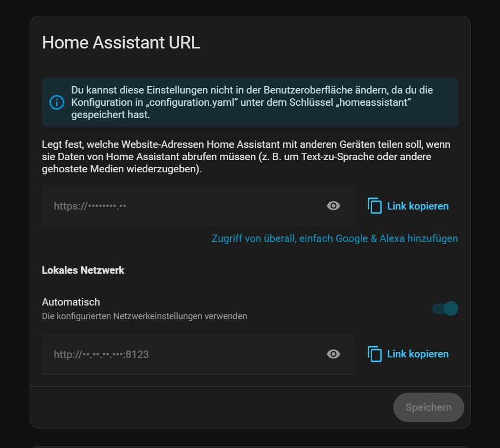

Home Assistant URL under System/Network is grayed out
Hello. I am having trouble changing my internal and external URL in System/Network. Everything is grayed out. To clarify, I do not have an entry under “homeassistant” in configuration.yaml. I can change the files in core.config, but they are still grayed out and blocked or grayed out by something.
How can I make the entries editable again or remove the gray background?
Above it says:
You cannot change these settings in the user interface because you have saved the configuration in “configuration.yaml” under the key “homeassistant.”
But that’s not true!
Regards, Thorsten

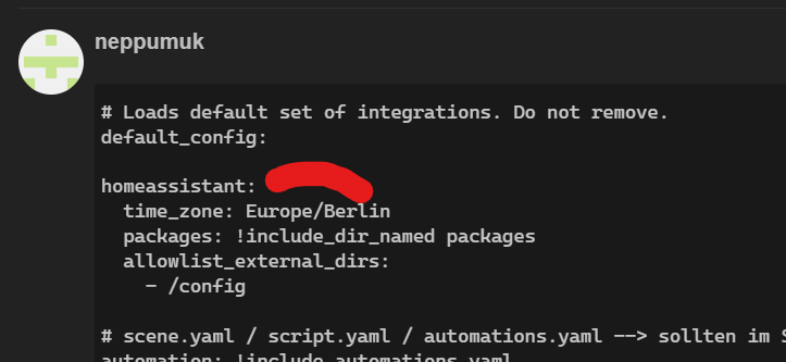

Can you show your configuration.yaml? be very careful editing core.config.
# Loads default set of integrations. Do not remove.
default_config:
homeassistant:
  time_zone: Europe/Berlin
  packages: !include_dir_named packages
  allowlist_external_dirs:
    - /config
# scene.yaml / script.yaml / automations.yaml --> sollten im Stammverzeichnis bleiben und nicht in packages
automation: !include automations.yaml
script: !include scripts.yaml
scene: !include scenes.yaml

In Packages i have only groups.yaml and zone.yaml.
It’s not lying though :slight_smile: Try removing /config from there.
Unfortunately, that didn’t help. Do you have any other ideas?
Did you comment out both the lines ‘config’ and the ‘allowlist_’ …
#   allowlist_external_dirs:
#      - /config
Yes. I have. :frowning:
The section you are showing now, is that the only one mentioning something? Cause if it is, it might be related to what you put under the http section. Not sure though, what happens if you comment that one out and verify the yaml (don’t reload remotely)
I showed my configuration.yml above…
I meant ‘is the error only shown at “ha url” configuration, le are there other locations where the error is present’
It’s more of a cosmetic flaw. But no, not only there.
