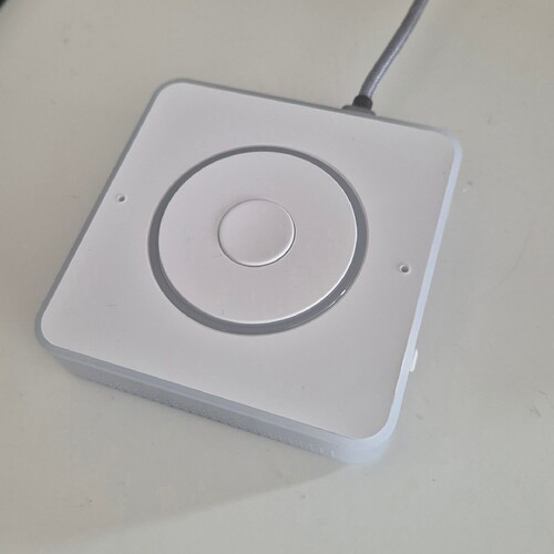

I did it! I tried for days to use local LLM, but my PC just wasn’t up to the task (cheap server). It can run whisper and piper though. So I was forced to go with the Google Generative AI and I don’t regret it. I wanted a smart voice assistant that works in Finnish. Now I got it and it’s smarter than Alexa even though it can’t do all the same things or atleast some are difficult to set up.
I would recommend this route with voice assistant for Home Assistant.
