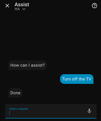

  • I have an automation setup to turn off my TV. Running the automation directly works properly, so my steps are correct.
  • When typing the command to HA Assist, it will run the automation properly.

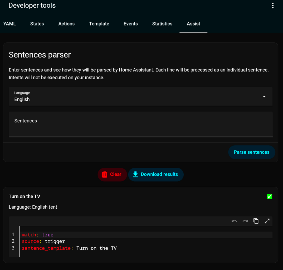

HA >> settings >> dev tools >> assist >> try command here and see what happen

I am currently using the faster-whisper STT provider and poper for TTS. Typing “Turn on the TV” to the sentence parser in Dev tools matches to the trigger:
The automation trigger’s are “Turn on the TV” and “Turn on TV”. When triggered, it has my Logitech harmony send a command to turn on the TV and set the input. From testing with text commands and manually triggering the automation, everything works as expected. The only issue arises when utilizing the HA Voice to try triggering this automation.

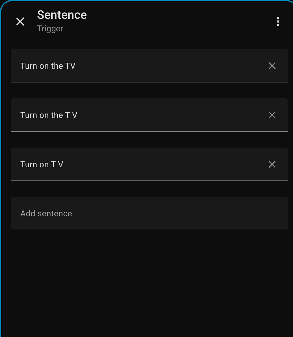

My first guess at a workaround would be to have another sentence trigger for “Turn on the T V” in addition to the other sentence. I will give this a test later today and update this post with my findings. Thank you for your insight!
I would do T B as well.
You can make it a list but I don’t know how if top of my head. Individual sentences are ok but I imagine you may need several variations.
Confirmed that HA Voice now runs the automation “Turn on the T V” without failing. T B is a good fallback, but looking at my logs seems to be un-necessary for my setup as it always picks up T V from my voice. Other voices or pronunciations may find this useful though.

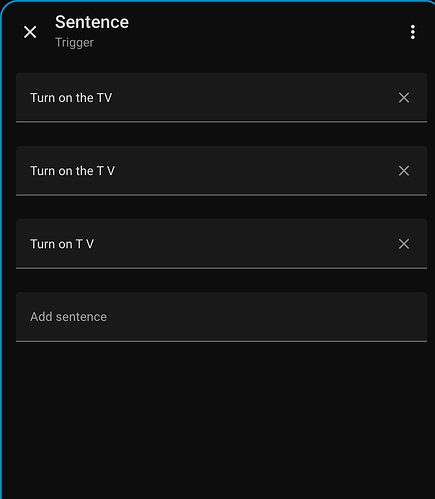

Here is how my sentence triggers look in HA:
Thanks for the assistance with this issue!
