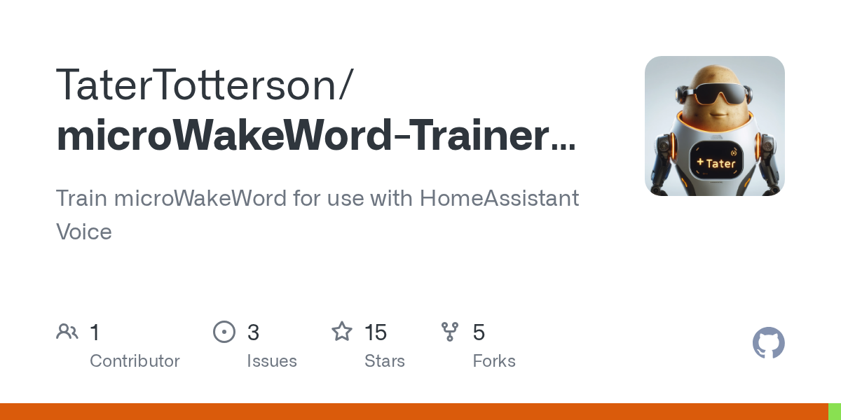

The one I posted above is working on a laptop 3070 with 8gb vram, nothing needs to be adjusted except for the wake word you want to use
It doesn’t take long to train the longest part is setting up all the training data
This is the original repo btw just updated and moved to a different git account
There is a apple silicon trainer working also thanks to the recent piper sample generator update
ill update it to include wget and ffmpeg, thanks
That’s good the early trainers were setup for 24g… Kind of absurd for oww2 training.

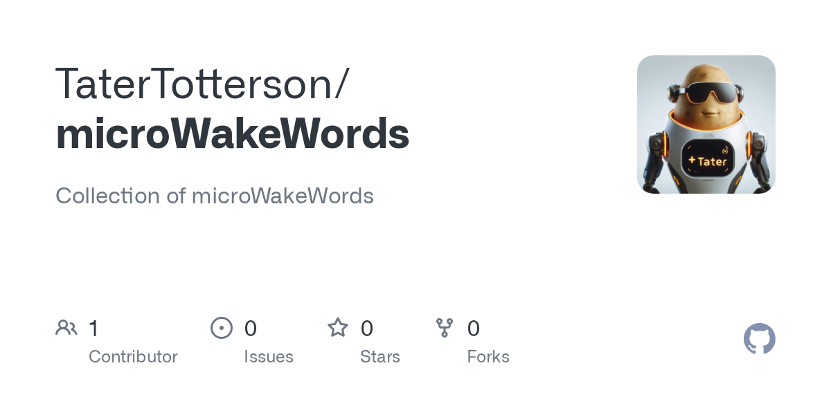

we could start a collection here if you guys want for people who dont have the means to train

There is also this one for training the MWW with a Nvidia card. No 50XX support as of yet though.

Big respect @TaterTotterson — this custom microwakeword setup is pure magic !! Thanks a lot !!
PS. Where’s the ā€˜buy me a coffee’ link in your github ? :slight_smile:
